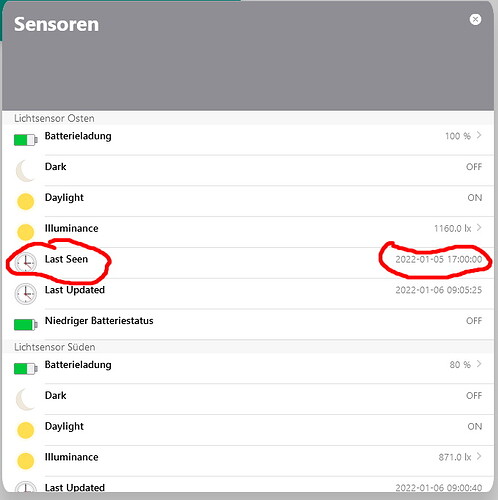

I use OH3.1 stable version. The query interval for “last seen” is set to 1440 by default. However, the “Last Seen” channel is unfortunately not updated daily, but only when I either restart OH or change the polling interval. However, an automatic, periodic update does not work, no matter what interval is set.

I use it to monitor my door sensors. For these, “last updated” is only updated when the door is opened. However, the doors are not opened regularly, so sometimes “last updated” remains unchanged for several days. “Last seen”, on the other hand, is updated regularly. It used to work perfectly in the past. My rules are designed for this.

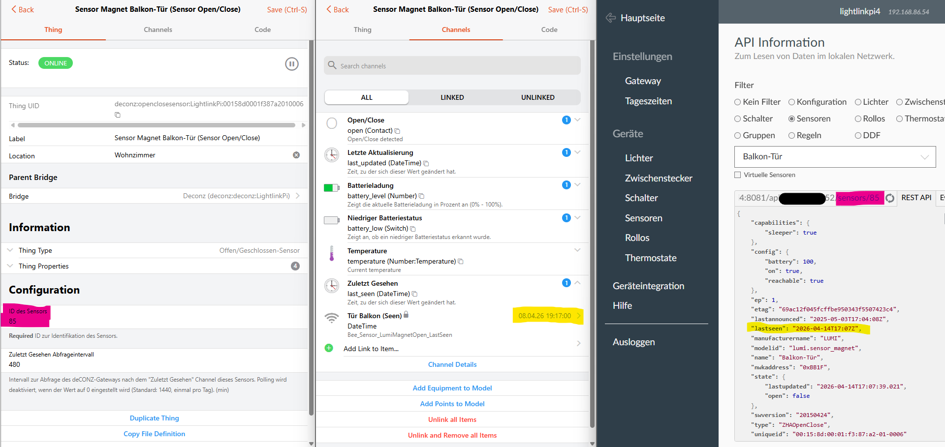

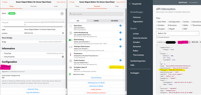

The “lastseen” value is updated correctly at first, but after some time it suddenly stops updating. If I disable and re-enable the Thing, it starts working again – but only temporarily, until it eventually stops updating again.
The screenshot shows that the value has been stuck for several days, even though the data in the API is still updating correctly.
It looks like the timer for the configured “Last Seen polling interval” stops running at some point, so the polling no longer happens.
