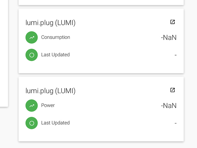

I added Xiaomi sensors with Conbee 2 to OH2 and working fine. I tried to add the Xiaomi Smart Plug but doesn’t work well.
I can add the Smart plug to Phoscon app as a lamp…but works I can switch off/on from Phoscon app the smart plug. I see the smart plug in the inbox of OH but NO on/off channels. If I see the plug in the Paper UI control menu hasn’t got on/off switch channels so I cannot magane the plug with OH.

I have installed the Hue binding and the deConz binding. All Xiaomi sensors work well. Only the Xiaomi smart plug doesn’t work good in OH because NO ON/OFF channel.
Any idea?

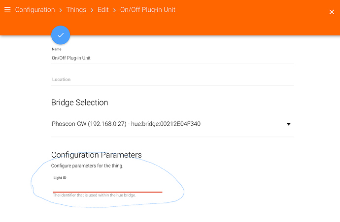

Did you try to add it manually via Paper UI?
Goto “Inbox” → Click “+”-button → Choose hue Binding → Click “Add manually” → Scroll down until you can see the “On/Off Plug-in Unit”
Until now I didn’t. But thank you for the idea I will try it.

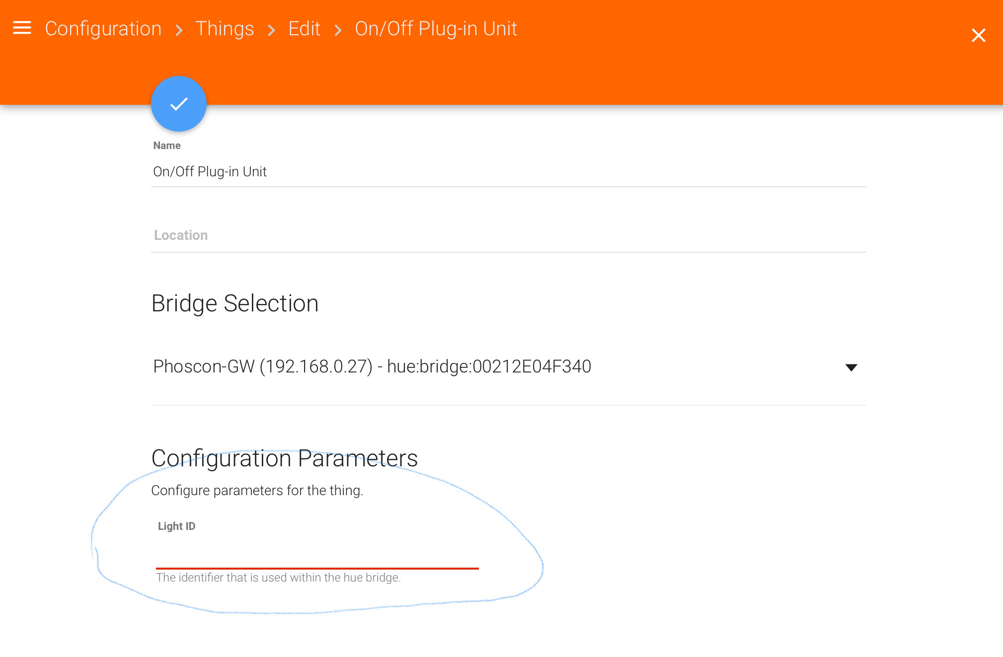

I tried but I don’t know what I have to write as a light ID?
You need to use the deCONZ Rest API.
Your deCONZ bridge is having a “key” - this is the apikey.
Use in your browser with the IP of your bridge and the api key:
192.168.178.XX/api/apikey/sensors
or with the Raspberry Pi console
curl -i -X GET 192.168.178.XX/api/apikey/sensors
