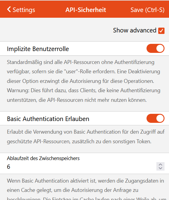

In http://192.168.0.163:8080/settings/services/org.openhab.restauth
you need to enable basic authentication.
That is already enabled :weary_face:
So you need to enter proper username and password for your openhab instance:
    sendHttpPutRequest("http://username:password@192.168.0.163:8080/rest/things/deconz:presencesensor:00212E027726:00158d000xxxxx6c010406/enable", "text/plain", 'true')
Hi Peter,
many thanks for screenshot! in my case Basic autthentification was disabled on base of hidden advanced settings… :disguised_face:
Now its look fine, the things will be reconnected successfully.
