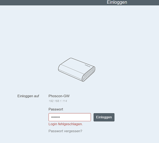

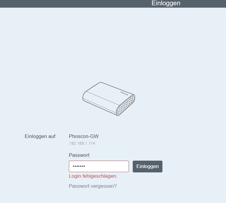

Tryed just an installation over the old and now I don´t come in ![]()
Hello Wolfgang
I´ve now restart service deconz and tried with delight but not accept the service deconz is running but I don´t get access

According to the Phoscon forum the password should be stored in file zll.db.
I would suggest to stop the deconz service and rename the file ( in that way you can go back in case this makes the situation worse ).
Then restart the service. Now it should be possible to set a password.
In case that does not work by using the URL Phoscon App try to directly connect to the deconz port on your Pi ( sudo netstat -tulpn | grep -i deconz should show the ports in use by deconz ).
According to other forums it might be necessary to clear the browsers cache.

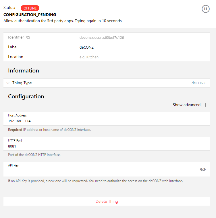

I have it working now. The App works. in Openhap there is now status INITIALIZING. One step in the right direction. I have used the direct way not over the internet. I used the local adress and port and there comes up the password side and all the other.
