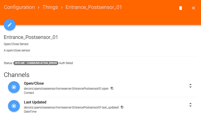

I´ve some trouble with sensors/devices which are randomly offline in openhav. I can control the device and can see updates in the Phoscon Software. The rest api information looks fine too of phoscon.
I don´t have a clue how to get better loggings.
I got the message “OFFLINE - COMMUNICATION_ERROR Auth failed” in PaperUI at the Thing.
Example:
grafik

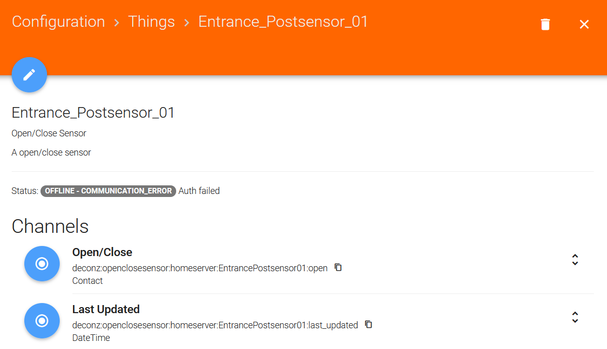

grafik
I rebootet the System.
I still got time outs, resulting that some things are offline.
For each thing that is offline on the deconz/phoscon bridge I got a time out.
I´m trying to understand the code above. Could it be that every thing sends a request on reboot to the bridge. Maybe because of several sensors I´m flooding the bridge with http requests in short intervalls?
With the hue plugin there are thing options to control the times between polling (thing options sensorPollingInterval & pollingInterval).
Are these missing for the deconz plugin?
