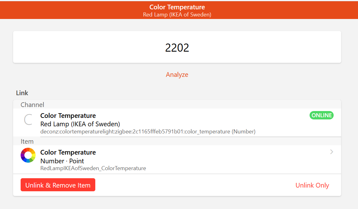

What item is linked to which channel?
To be honest I defined this item manually in an item file as “Dimmer”, which appears to be incorrect.
With a new item creation the item is a number.
fyi The range (changing in Phoscon and reading the value in Openhab) is 2200 - 4000 (Kelvin)
So problem solved, will solve changing this value in Openhab later this day.
Thanks for put me on the right track of own problem.
The problem with ctmin/ctmax is that openHAB relies on the values reported by the deconz API. It could be that Phoscon has an additional internal database for that.
Do you see a ctmin/ctmax value in the log (set level to TRACE) for this device when you disable/enable it?
Problem already solved; I should have defined the color-item as a number and not as a dimmer, the value itself of this channel (deconz:colortemperaturelight:zigbee:2c1165fffeb5791b01:color_temperature) can vary between 2202 and 4000.
