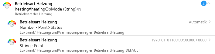

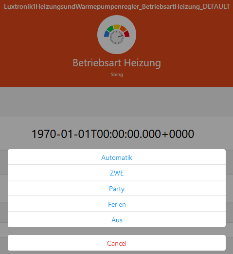

With that channel one should also be able to set the state in the UI. So far this works very well. But I’m not able to define the tag in that way, that the link creation automatically creates a proper state item. Instead it shows a date (with value 0).
Clicking on the item opens the correct input menu though.
The item suffixed with _DEFAULT is simply created by “Add Link to Item” → “Create a new Item” → “Link”
The “correct” item with also setting the Type to Number and Semantic Class to Status.
Is there anything I can change to “fix” the link creation? What am I missing? I tried adding state/commands/command but to no avail…
