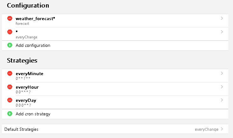

Anyway, I now have the following configuration:
And this is the associated code:

Maybe this is totally expected but as it caught me by surprise, I’m writing this message to warn others facing the same situation.
I think this is worthy of an issue. There should be a way in the UI to define a strategy for all items.
