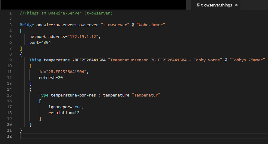

So after some try & error I created this:
Bridge onewire:owserver:towserver [ network-address="172.19.1.12", port=4304 ]{

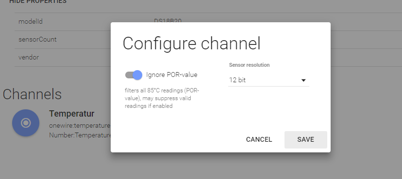

    Thing temperature 28_FF2526A41504 [ id="28.FF2526A41504", refresh=5 ] { Type temperature-por-res : temperature [ ignorepor=true, resolution=12 ] }

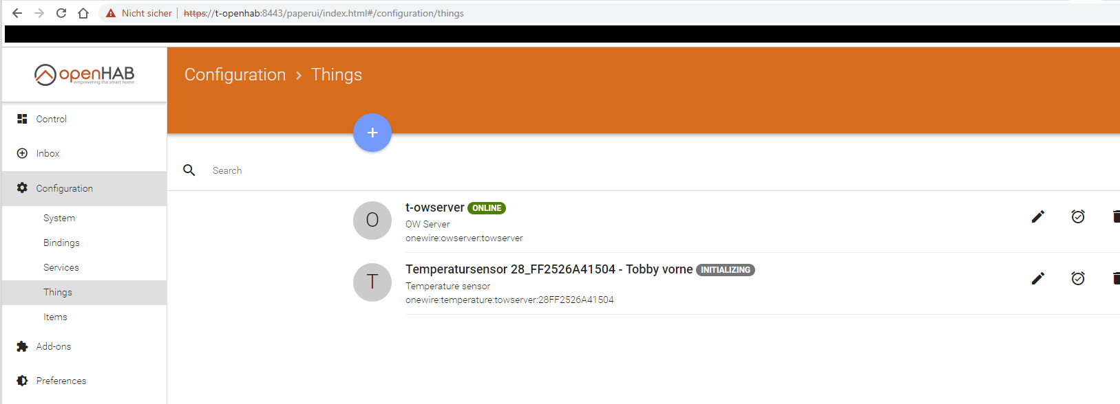

This now looks in PaperUI exactly the same like my auto discovered and configured stuff, but it stays on “initialized” forever and never comes “online”.
Any ideas what I am doing wrong?

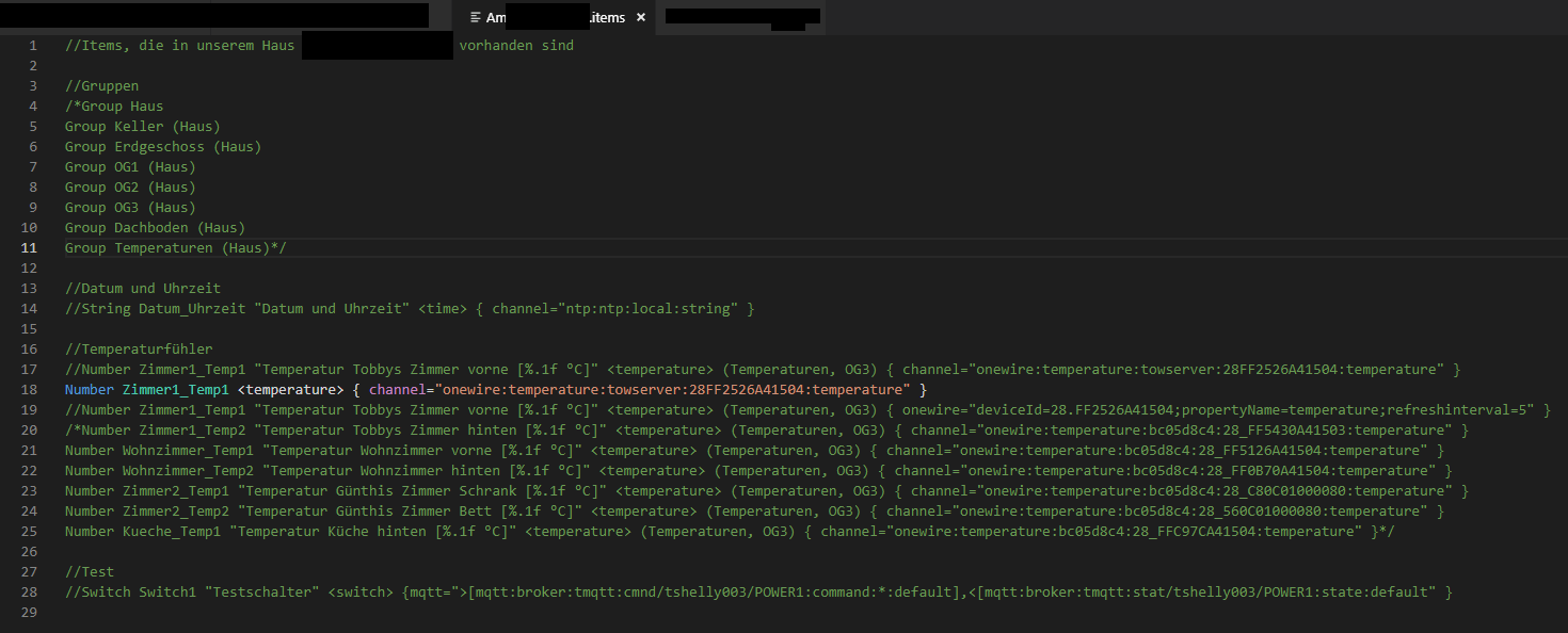

Yes I created items for my things. So this works with my auto-discovered thing:
Number Zimmer1_Temp1 "Temperatur vorne [%.1f °C]" <temperature> (Temperaturen, OG3) { channel="onewire:temperature:bc05d8c4:28_FF2526A41504:temperature" }

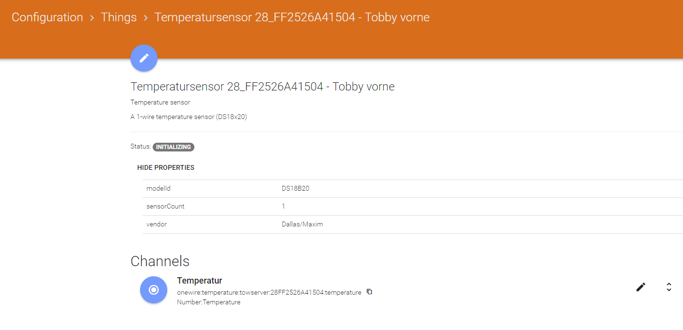

I can use this item in my sitemap and it shows the temperature (and Paper UI shows the thing as “online”)
But this does not work with my self defined item (which looks the same in Paper UI, but stays on “initializing”)
Number Zimmer1_Temp1 "Temperatur vorne [%.1f °C]" <temperature> (Temperaturen, OG3) { channel="onewire:temperature:towserver:28_FF2526A41504:temperature" }
No temperature is shown when I include this to my sitemap. It stays “initializing”.
And for sure I am not using both with the same name at the same time :wink:

Did you change the item to use UOM feature (add Temperature) like below?
Number:Temperature  Zimmer1_Temp1 "Temperatur vorne [%.1f °C]"
Changed “Number” to “Number:Temperature” in my items-file. No change, still “initializing” (and no value is shown when viewing my sitemap in the Basic UI)
Was your Bridge also deleted from PaperUI after adding it to your things file? I ask b/c the log mentioned the connection already open. I would also rename the file from t-owserver.things to t_ownserver.things.
In case your wondering, yes I’m grasping for straws at this point.:neutral_face:
Yes, I purged everything (the whole installation) and added all devices just by using the things-file…
Tried to rename my things file, too.
No change :frowning:
I now added some MQTT stuff by defining it in my things file. This works. But my temperature sensors still don’t :frowning: Maybe I should open an issue on Github.
