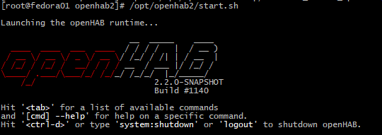

The line in the start.sh has not been executing with the recent openhab 2.2 snapshots. Any idea why or how to fix?
I update snapshot versions often (currently on 1140) and it is working for me.
I just looked again and its definitely not working. It was fine in 2.1. I’m on Build #1143 , but the previous builds were not working either. Perhaps this has to do with my apt based installation?
My /usr/share/openhab2/start.sh
#!/bin/sh
mv `\ls -1 /etc/openhab2/rules/*.rules | grep -v Startup.rules` /etc/openhab2/rules/prestart
echo Launching the openHAB runtime...
DIRNAME=`dirname "$0"`
exec "${DIRNAME}/runtime/bin/karaf" "${@}"
I also never see “Launching the openHAB runtime…” in the log which makes me think that this file is no longer accessed.
Hmmm. I have a manual install and launch OH from a screen session. I restarted last night and confirmed again that the rules were being moved.
According to the following, the startup service has been changed to directly start karaf and no longer calls start.sh.
There may be a more elegant want to get the command to run, but I edited my start.sh to comment out the exec line. Then add the following line to /usr/lib/systemd/system/openhab2.service.
ExecStartPre=-/usr/share/openhab2/start.sh
On service start, it will execute start.sh with the mv command first. Then it will start karaf. Likely there is a way to format the mv command to run right from the openhab2.service, but I didn’t have time to figure that out.
