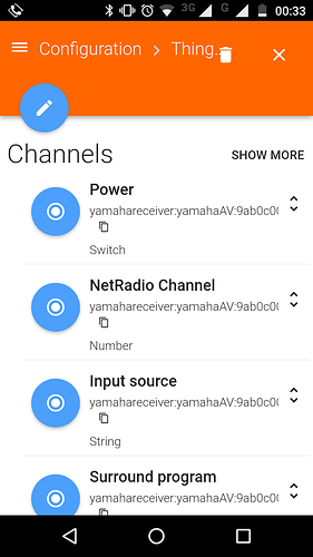

Did you activate the channels after adding the thing?
In your Denon thing you should have channels looking like this.
If the circle is empty they won’t appear in the control section of Paper UI.
A short click on them activates/deactivates the channel.
