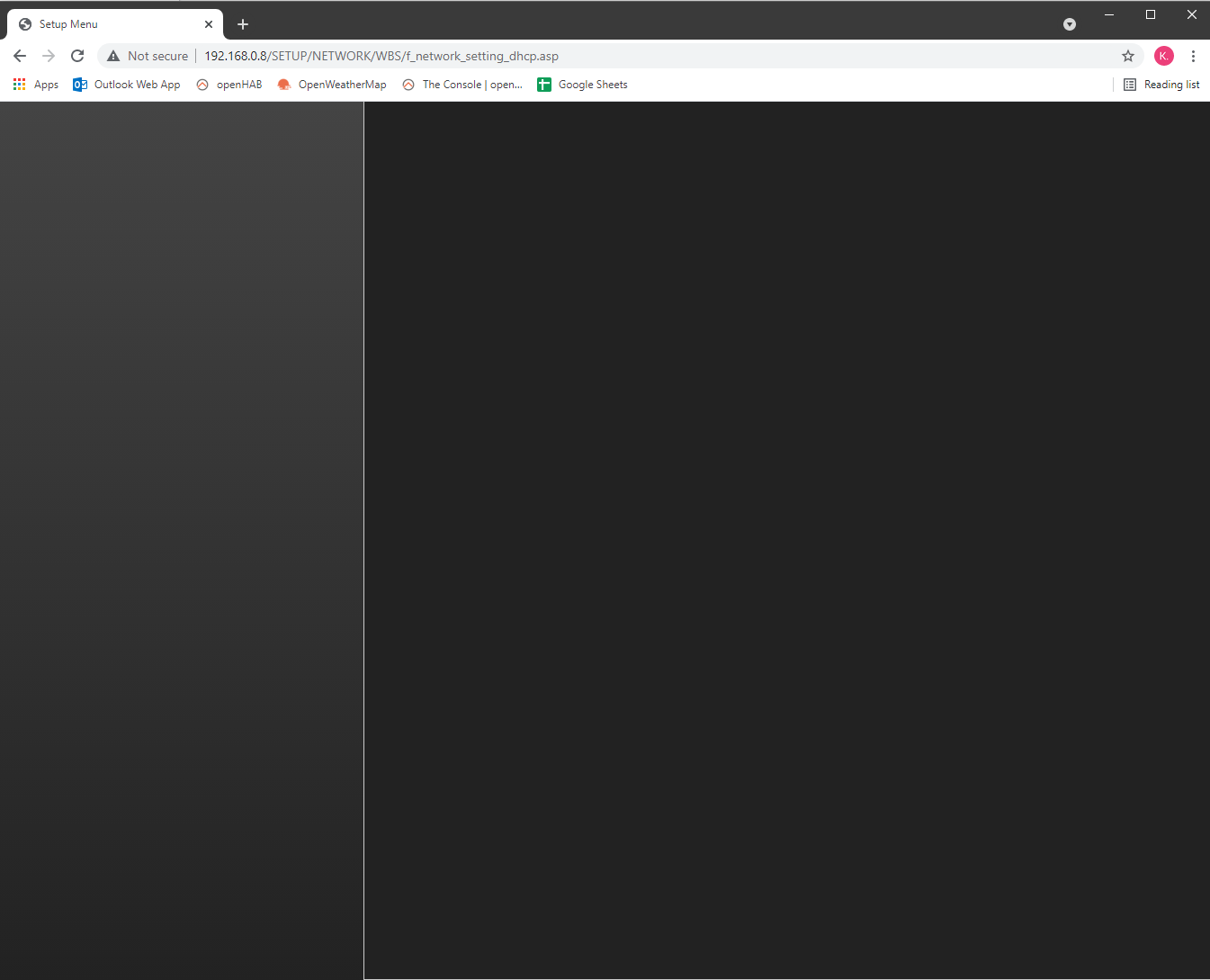

I am having similar issues with items updating. I checked Denon Web Control by entering the IP of my receiver in a browser(s). It appears to be broken, as the page is there, but no menu items.
I also remember a Denon update in the past few weeks. Not sure if any of this is related, but seems like it could be.
