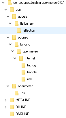

Here is the content of the JAR file:
I must have done something wrong but I can’t figure out what despite reading lots of messages around here and trying quite a few things in both the pom.xmland feature.xml files

When embedded, you don’t need to add it to the feature.
And there it is, the combination that I did not try!
I removed it from feature.xml, cleared cache, rebuilt, and…
It works!
Thanks for pointing this out.
