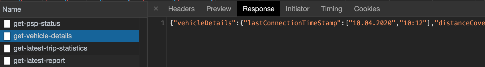

I need someone who owns an electrical car to login into to the VW We Connect portal and use the developer tools to debug the API calls for emanager and send me info about them in a PM.
Sweet, sure, i can do that - do you have some more specific instructions? :slight_smile:
i’m logged in, and have dev tools open, but not sure what you need :slight_smile:
/Chris
The get-xxx API calls that I’m interested in are the ones that are unique for electric cars:
For fetching vehicle status:
  • -/emanager/get-emanager
  • /-/emanager/get-notifications
For performing actions:
  • /-/emanager/charge-battery
  • /-/emanager/trigger-climatisation
  • /-/emanager/trigger-windowheating
and I’m interested in both how the POST message in sent and how the JSON response for the status API calls looks like.
If you also can see a get-status API call, I would be interested to get more info on which parameters that the call uses and how the reponse looks like.

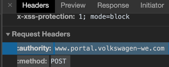

What I’m partculary interested in the API calls are the part that is listed under ‘Request Headers’ in the Headers tab:
It is possible to mark the text and copy it via Ctrl-c and then pasting in in a text document with Ctrl-v .
The sensitive data part that you can mask in the vehicle VIN number, this is how the get-status API call looks in my browser:
`Request Headers``
:authority: www.portal.volkswagen-we.com
:method: POST
:path: /portal/delegate/dashboard/WVxxxxxxxxxxxxxxxxxx/-/rah/get-status
:scheme: https
accept: application/json, text/plain, */*
accept-encoding: gzip, deflate, br
accept-language: sv-SE,sv;q=0.9,en-US;q=0.8,en;q=0.7
content-length: 0
content-type: application/json;charset=utf-8
cookie: adbCDP=2; COOKIE_SUPPORT=true; CARNET_LANGUAGE_ID=sv_SE; _sdsat_Opt_Out=false; GUEST_LANGUAGE_ID=sv_SE; sc_appvn=VWConnectLandingpage2%3E1%3E1%7CCar-NetCMS%3E2%3E2; AMCVS_1D59171B520E91320A490D44%40AdobeOrg=1; s_cc=true; VW_COOKIE_AGREEMENT=true; AMCV_1D59171B520E91320A490D44%40AdobeOrg=-1303530583%7CMCIDTS%7C18359%7CMCMID%7C38009297664418318793053385746933707846%7CMCAAMLH-1586805483%7C6%7CMCAAMB-1586805483%7CRKhpRz8krg2tLO6pguXWp5olkAcUniQYPHaMWWgdJ3xzPWQmdj0y%7CMCOPTOUT-1586207883s%7CNONE%7CMCAID%7CNONE%7CvVersion%7C3.3.0; sc_prop32=Car-Net; s_vnum=1588284000169%26vn%3D1; s_invisit=true; sc_appvn=VWConnectLandingpage2%3E1%3E1%7CCar-Net%3E1%3E1; s_cc=true; sc_prevpage=Car-Net%20%3A%20home%20%3A%20Viewport%20%3A%20top-of-page; LFR_SESSION_STATE_20159=1586200954456; JSESSIONID=955B2C27727AC9DD3187D0E92CD438E2.green-1
origin: https://www.portal.volkswagen-we.com
referer: https://www.portal.volkswagen-we.com/portal/delegate/dashboard/WVxxxxxxxxxxxxxxxx
sec-fetch-dest: empty
sec-fetch-mode: cors
sec-fetch-site: same-origin
user-agent: Mozilla/5.0 (Macintosh; Intel Mac OS X 10_14_5) AppleWebKit/537.36 (KHTML, like Gecko) Chrome/80.0.3987.149 Safari/537.36
x-csrf-token: XdSCOei7
Response JSON
{"errorCode":"0","timerCount":3,"remoteAuxiliaryHeating":{"status":{"active":false,"operationMode":"HEATING","outdoorTemp":"8 °C","remainingTime":30},"timers":[{"timerId":1,"active":false,"weekDay":6,"time":{"hours":0,"minutes":0},"nextActivationDate":"11.04.2020"},{"timerId":2,"active":false,"weekDay":6,"time":{"hours":0,"minutes":0},"nextActivationDate":"11.04.2020"},{"timerId":3,"active":false,"weekDay":6,"time":{"hours":0,"minutes":0},"nextActivationDate":"11.04.2020"}]}}

I’ve would need to see the login sequence to the Skoda Connect Web Portal and also the API calls for fetching status info and for actions.
The VW API has the following status API endpoints:
  • mainnavigation/load-car-details
  • vehicle-info/get-vehicle-details
  • vsr/request-vsr
  • vsr/get-vsr
  • rts/get-latest-trip-statistics
  • cf/get-location
  • rah/get-status
  • emanager/get-emanager
and the following action URLs:
  • vsr/remote-lock/unlock
  • rah/quick-start/stop
  • emanager/charge-battery
  • emanager/trigger-climatisation
  • emanager/trigger-windowheating
Use your browsers developer tools (In Chrome right-click and select Inspect), then use the Network tab to trace all HTTP traffic between your browser and the Skoda Connect Portal. Look for HTTP POST containing get-xxx e.g.
Check Headers for the complete API POST and Response for the JSON response.
Save them all in a log file and send to me in a PM. Make sure not to include any login details.
I suspect the Skoda Connect Portal has a totally different API, hence it will be very difficult for me to reverse engineer it, since I don’t own a Skoda.
