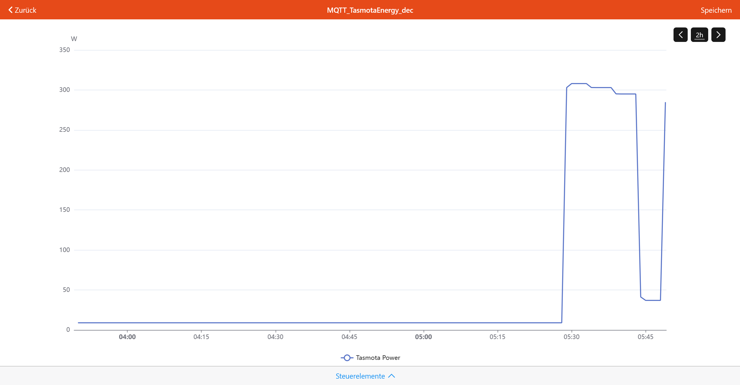

From the total power consumption of the house, it should be possible to derive which machine is switched on and consuming power under the condition that I have measurements from the power consumption of single devices (fridge, TV, pumps, washing machine) etc. Note that the consumption of the single devices is not currently measured, its data from the past. But still, the timeline should tell me which devices are used.
Having a look at picture 1 (Total Power Consumption), you can see regular curves from the fridge.
At 5:30, the heating also turns on (see picture 2). Now you have a much higher energy consumption, but you can still see the profiles from heating and fridge from the pictures.
So the aim is that I only measure the total heat consumption and can derive which devices are on from this single data.
