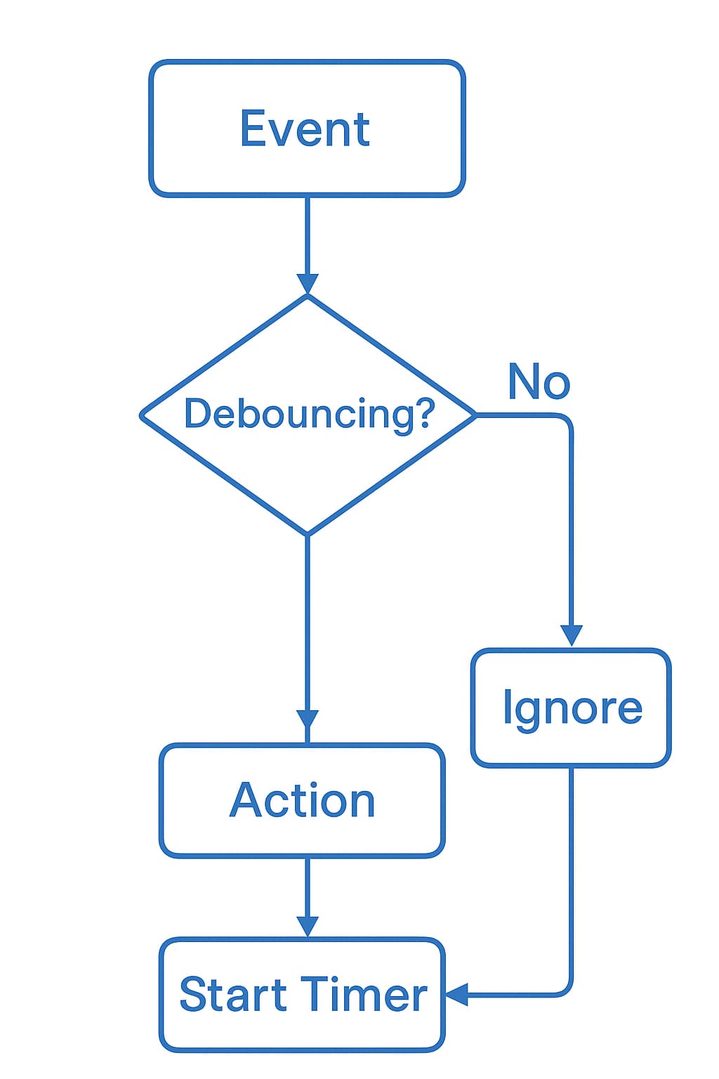

Problem: Some sensors produce very fast, consecutive state changes, e.g., motion detectors or buttons.
Without filtering, these can trigger multiple unwanted actions.
Solution:
  • Use a timer-based “debounce” mechanism.
  • After the first event, start a timer (e.g., 2 seconds).
  • During this time, no new actions are executed.
  • Only after the timer expires are new state changes accepted.
Benefits:
  • Reduces unwanted duplicate actions.
  • Especially useful for unstable sensors or buttons.

Rule DSL Explanation:
  • debounceTimer prevents multiple actions from being triggered within the 2-second period.
  • After the timer expires, it is reset and new events are processed.
  • Especially useful for sensors that send signals in rapid succession.
