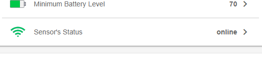

I have lots of stuff written for this but not for the sitemap part. For that I’d probably use what rossko57 suggests and use visibility tag. What I actually do is use subframes and Group aggregation. For example, my door status looks like:
which opens up to

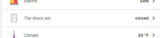

So at the top of my sitemap I see a summary and based on that summary I can drill down as necessary.

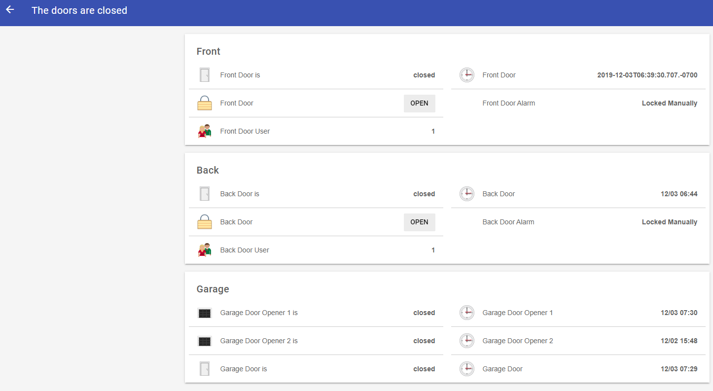

The sitemap section is:
Text item=gDoorSensors {
Frame label="Front" {
Text item=vFrontDoor
Text item=vFrontDoor_LastUpdate
Switch item=aFrontDoor_Lock label="Front Door" icon="lockclosed" mappings=[ON=Open] visibility=[aFrontDoor_Lock == ON]
Switch item=aFrontDoor_Lock label="Front Door" icon="lockopen" mappings=[OFF=Lock] visibility=[aFrontDoor_Lock == OFF]
Text item=vFrontDoor_Alarm
Text item=vFrontDoor_User visibility=[vFrontDoor_User!="0"]
Frame label="Back" {
Text item=vBackDoor
Text item=vBackDoor_LastUpdate
Switch item=aBackDoor_Lock label="Back Door" icon="lockclosed" mappings=[ON=Open] visibility=[aBackDoor_Lock == ON]
Switch item=aBackDoor_Lock label="Back Door" icon="lockopen" mappings=[OFF=Lock] visibility=[aBackDoor_Lock == OFF]
Text item=vBackDoor_Alarm
Text item=vBackDoor_User visibility=[vBackDoor_User != 0]
Frame label="Garage" {
Text item=vGarageOpener1
Text item=vGarageOpener1_LastUpdate
Text item=vGarageOpener2
Text item=vGarageOpener2_LastUpdate
Text item=vGarageDoor
Text item=vGarageDoor_LastUpdate
And the gDoorSensors Group is defined as
Group:Contact:OR(OPEN,CLOSED) gDoorSensors "The doors are [MAP(en.map):%s]" <door>

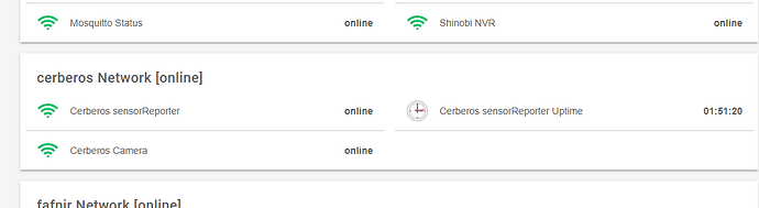

My sensor and services online status alerting works a little differently. In this case I don’t need a reminder at some point in the future, I want an alert immediately. And a lot of these are using the Network binding so I’m forced to use Switches.
Sitemap:
Items:
Group:Switch:AND(ON, OFF) gSensorStatus "Sensor's Status [MAP(admin.map):%s]"
<network>
Switch vNetwork_cerberos "cerberos Network [MAP(admin.map):%s]"
<network> (gSensorStatus, gResetExpire)
{ channel="network:servicedevice:cerberos:online",
expire="2m",
name="cerberos" }
// Garage Camera
Switch vCerberos_Camera_Online "Cerberos Camera [MAP(admin.map):%s]"
{ channel="network:servicedevice:garagecamera:online",
expire="2m",
name="Garage Camera" }
// cerberos sensorReporter
Switch vCerberos_SensorReporter_Online "Cerberos sensorReporter [MAP(admin.map):%s]"
<network> (gSensorStatus, gResetExpire, sensorReporters, DeviceControllers)
{ expire="2m,command=OFF",
name="cerberos sensorReporter" }
As with above, I use name to provide a nice name for each Item to use in alerts.
