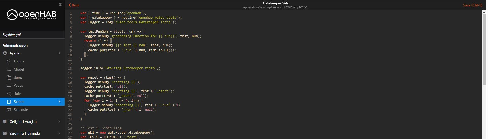

Hello All,
runtimeInfo:
  version: 3.1.0
  buildString: Release Build
locale: default
systemInfo:
  configFolder: /etc/openhab
  logFolder: /var/log/openhab
  javaVersion: 11.0.12
  javaVendor: Azul Systems, Inc.
  javaVendorVersion: Zulu11.50+19-CA
  osName: Linux
  osVersion: 5.10.60-sunxi
  osArchitecture: arm
  availableProcessors: 4
  freeMemory: 68282840
  totalMemory: 253845504
bindings:
  - serial
  userAgent: Mozilla/5.0 (Windows NT 10.0; Win64; x64) AppleWebKit/537.36 (KHTML,
    like Gecko) Chrome/94.0.4606.61 Safari/537.36
timestamp: 2021-09-24T08:15:43.999Z
ı want to use this script for my group commands,
https://community.openhab.org/t/design-pattern-gate-keeper/36483#oh-3x-javascript-6
but I couldn’t figure out how to install and prepare this tool.
i read this article,
https://github.com/rkoshak/openhab-rules-tools
and this
https://github.com/rkoshak/openhab-rules-tools/tree/main/gatekeeper
and this
https://www.openhab.org/docs/configuration/jsr223.html#script-locations
I can’t find the automation folder’s location in OH3.
Can you explain in detail how to install and use the libraries on OH3?
I’m new to the Openhab ecosystem, I don’t know about scripts and libraries. I’ve been reading many topics and manuals, but I haven’t been able to put the platform in my head yet.
-Which method is faster
-Which method uses fewer resources,
-which method is stable and trouble-free.
I am an embedded system designer and code developer.
I am trying to learn which one is closer to me or more efficient.
Thank you for your time
It might not be created automatically. You can create it by hand though. On Linux
sudo -u openhab mkdir /etc/openhab/automation
Or when you follow the instructions to copy the library to your config, the needed folders will be created for you. Just cp -r openhab-rules-tools/gatekeeper/python/automation /etc/openhab.
Note that gatekeeper depends on time_utils so you need to copy that over too.
So the steps are:
  1. clone openhab-rules-tools
  2. cp -r openhab-rules-tools/time_utils/javascript/automation /etc/openhab
  3. cp -r openhab-rules-tools/gatekeeper/javascript/automation /etc/openhab
Done, the libraries are now installed.
The example in the readme for gatekeeper should show how to use it. At a high level, import the library, instantiate a Gatekeeper Object and use it. The test code is often helpful for examples as well.
If you run into trouble let us know.

Hi All,
I am trying the Gatekeeper Script and test example for a week but I am facing the below error, again by again.
my system configuration is this.

and the Gatekeeper test code is;
var { time } = require('openhab');
var { gatekeeper } = require('openhab_rules_tools');
var logger = log('rules_tools.Gatekeeper Tests');
var testFunGen = (test, num) => {
  logger.debug('generating function for {} run{}', test, num);
  return () => {
    logger.debug('{}: Test {} ran', test, num);
    cache.put(test + '_run' + num, time.toZDT());
logger.info('Starting Gatekeeper tests');
var reset = (test) => {
  logger.debug('resetting {}');
  cache.put(test, null);
  logger.debug('resetting {}', test + '_start');
  cache.put(test + '_start', null);
  for (var i = 1; i <= 4; i++) {
    logger.debug('resetting {}', test + '_run' + 1)
    cache.put(test + '_run' + i, null);
// Test 1: Scheduling
var gk1 = new gatekeeper.Gatekeeper();
var TEST1 = ruleUID + '_test1';
reset(TEST1);
cache.put(TEST1 + '_start', time.ZonedDateTime.now());
gk1.addCommand('PT1s', testFunGen(TEST1, 1));
gk1.addCommand('PT2s', testFunGen(TEST1, 2));
gk1.addCommand('PT3s', testFunGen(TEST1, 3));
gk1.addCommand(500, testFunGen(TEST1, 4));
actions.ScriptExecution.createTimer(time.toZDT('PT6.51s'), () => {
  var success = true;
  const start = cache.get(TEST1 + '_start');
  const run1 = cache.get(TEST1 + '_run1');
  const run2 = cache.get(TEST1 + '_run2');
  const run3 = cache.get(TEST1 + '_run3');
  const run4 = cache.get(TEST1 + '_run4');
  if (start === null) {
    logger.error('{} Failed to get starting timestamp', TEST1);
    success = false;
  if (success && run1 === null) {
    logger.error('{} run1 failed to run!', TEST1);
    success = false;
  if (success && run2 === null) {
    logger.error('{} run2 failed to run!', TEST1);
    success = false;
  if (success && run3 === null) {
    logger.error('{} run3 failed to run!', TEST1);
    success = false;
  if (success && run4 === null) {
    logger.error('{} run4 failed to run!', TEST1);
    success = false;
  if (success) {
    logger.info('\n{}\n{}\n{}\n{}\n{}', start.toString(), run1.toString(), run2.toString(), run3.toString(), run4.toString());
    const dur1 = time.Duration.between(run1, run2).seconds();
    const dur2 = time.Duration.between(run2, run3).seconds();
    const dur3 = time.Duration.between(run3, run4).seconds();
    if (start.isAfter(run1)) {
      logger.error('{} failed, run1 ran before start!', TEST1);
      success = false;
    if (success && dur1 != 1) {
      logger.error('{} failed, time between run1 and run2 is {} seconds.', dur1);
      success = false;
    if (success && dur2 != 2) {
      logger.error('{} failed, time between run2 and run3 is {} seconds', dur2);
      success = false;
    if (success && dur3 != 3) {
      logger.error('{} failed, time between run3 and run4 is {} seconds', dur3);
    if (success) {
      logger.info('Gatekeeper test 1 success!');
// Test 2: cancelAll
var gk2 = new gatekeeper.Gatekeeper();
var TEST2 = ruleUID + '_test2'
reset(TEST2);
gk2.addCommand('PT1.5s', testFunGen(TEST2, 1));
gk2.addCommand('PT2s', testFunGen(TEST2, 2));
gk2.addCommand('PT3s', testFunGen(TEST2, 3));
gk2.addCommand(500, testFunGen(TEST2, 4));
actions.ScriptExecution.createTimer(time.ZonedDateTime.now().plus(2750, time.ChronoUnit.MILLIS), () => {
  var success = true;
  const run1 = cache.get(TEST2 + '_run1');
  const run2 = cache.get(TEST2 + '_run2');
  const run3 = cache.get(TEST2 + '_run3');
  const run4 = cache.get(TEST2 + '_run4');
  if (!run1) {
    logger.error('{} failed, run1 did not run', TEST2);
    success = false;
  if (success && !run2) {
    logger.error('{} failed, run2 did not run', TEST2);
    success = false;
  if (success && run3) {
    logger.error('{} failed, run3 ran too soon', TEST2);
    success = false;
  if (success && run4) {
    logger.error('{} failed, run4 ran too soon', TEST2);
    success = false;
  if (success) {
    gk2.cancelAll();
    actions.ScriptExecution.createTimer(time.toZDT('PT4s'), () => {
      var success = true;
      if (run3) {
        logger.error('{} failed, run3 ran after being cancelled');
        success = false;
        logger.error('{} failed, run4 ran after being cancelled');
      if (success) {
        logger.info('Gatekeeper test 2 success!')
and the error is;
