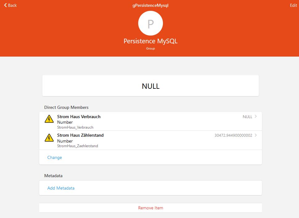

I would like to use Group Based Persistence in OH3.4. In my example I have put the items StromHaus_Verbrauch/StromHaus_Zaehlerstand into the group gPersistenceMysql, but for these items the default persistance is still used as my rule gives following error:
[WARN ] [nce.extensions.PersistenceExtensions] - There is no default persistence service configured!
[WARN ] [nce.extensions.PersistenceExtensions] - There is no queryable persistence service registered with the id ‘null’
[ERROR] [internal.handler.ScriptActionHandler] - Script execution of rule with UID ‘d3745560f2’ failed: cannot invoke method public abstract org.openhab.core.types.State org.openhab.core.persistence.HistoricItem.getState() on null
Any idea what is wrong?
