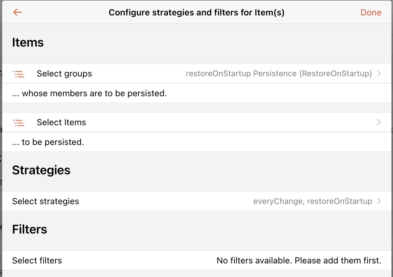

Managed Configs
Navigate to Settings → Persistence and select the desired add-on to configure under “Configure Persistence Policies”.
MapDB Config:
  1. Click “add configuration”, click “Select groups” and select “RestoreOnStartup”
  2. Under “strategies” make sure “everyChange” and “restoreOnStartup” are selected
Note, if you want to apply filters, create the filter first and then select the filter(s) you want to apply for this Group under “Select filters”.
Repeat the steps above for RRD4J and InfluxDB, selecting the Group name and strategies and filters (if applicable) as appropriate.

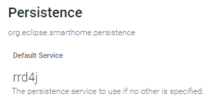

I did the setup as described in the first post of this thread. I want to use MapDB for restore on startup and RRD4J for charting. After switching from my approach - which was to include specific items into rrd4j.persist - to using groups, it doesn’t render the charts anymore.
My rrd4j.persist file:
Strategies {
    everyMinute:    "0 * * * * ?"
    every10Minute:  "10 * * * * ?"
    everyHour:      "0 0 * * * ?"
    everyDay:       "0 0 0 * * ?"
    default = everyChange
Items {
    gR* : strategy = everyUpdate, everyMinute
// .items File
    Group gM            // mapdb - persist all items on every change and restore them from the db at startup
    Group gR            // rrdj4 - for Items to preserve their history + charting
    String SonoffS201_wifirssi      "Sonoff S20 #1: Wifi RSSI [%s]"     (gM,gR,Gsonoff) { channel="mqtt:topic:mosquitto:sonoff_0xxx:Sonoff_0xxx_rssi" }
test.sitemap
   Frame label="Charts Sonoff S20" {
        Text item=Gcharts {
            Chart item=SonoffS201_wifirssi refresh=60000 period=h service="rrd4j" legend=true
I always get this message - for all items I’ve tried so far:
[WARN ] [thome.ui.internal.chart.ChartServlet] - Chart generation failed: null
With no charts:
http://openhabianpi:8080/rest/persistence
delivers:
[{"id":"mapdb","label":"mapdb","type":"Queryable"},{"id":"rrd4j","label":"rrd4j","type":"Queryable"}]
Default persistence is set to rrd4j:
Unfortunately I don’t use rrd4j any more and I don’t use OH generated charts any more so I don’t really have anything to offer. What you have posted looks like it should work and the error is not informative.
