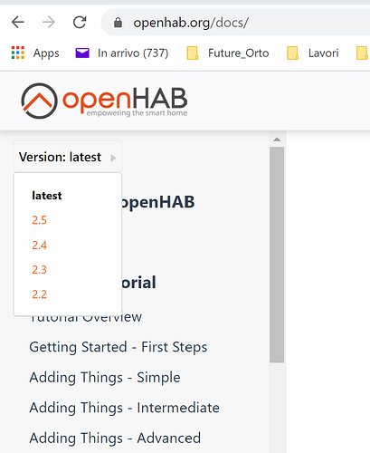

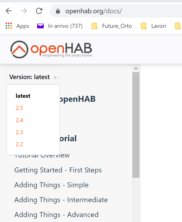

openhab.org was for 2.x as this screnshot seemed to confirm
