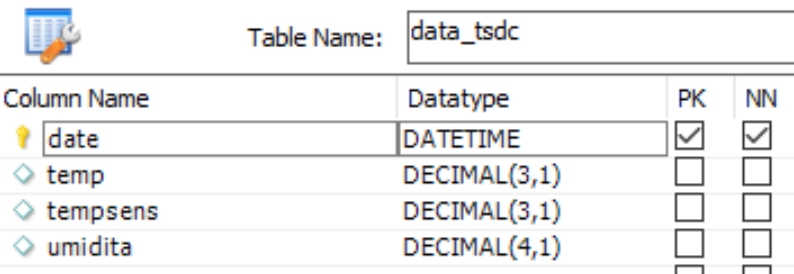

d) set up a new table with optimized structure, something like

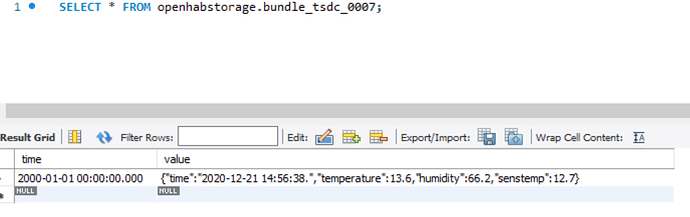

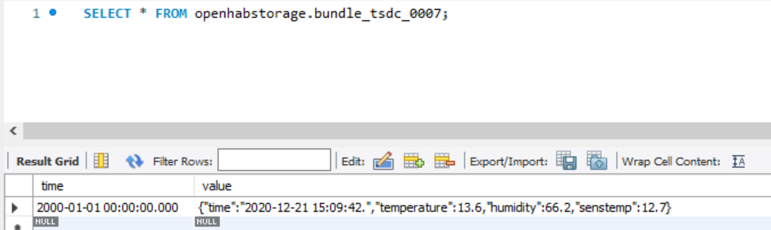

Result is what I expected, that is:
optimized table
OH transit table
