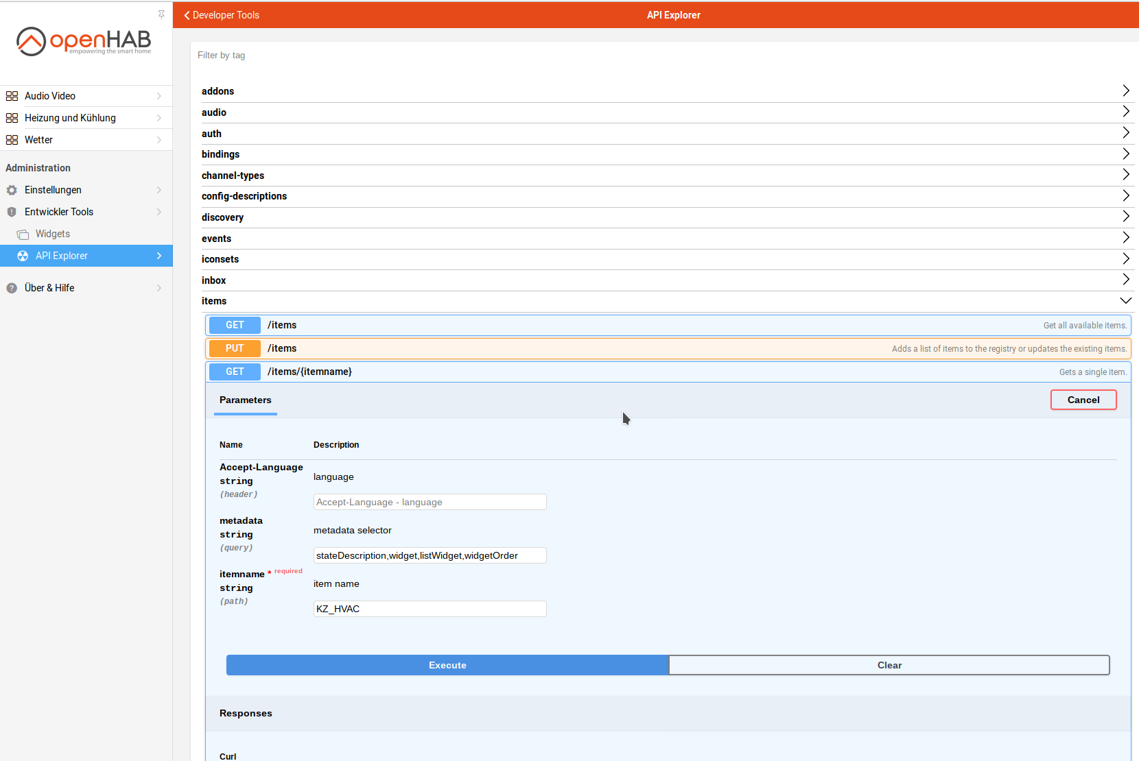

One of the big complaints about the UI is all the repetitious clicking around to produce a lot of similar things. For example, creating a lot of similar MQTT Things, applying Expire to a bunch of Items, creating a bunch of similar rules, etc. But you don’t have to do that.
  1. Create an exemplar using the UI
  2. Open the API Explorer from the Developer Tools
  3. Query for your exemplar and copy the JSON
  4. Navigate to the “create” end point and paste in the JSON
  5. Edit the JSON for your new instance
  6. Click submit to create the new instance
  7. Repeat steps 5 and 6 for all the other similar stuff.
I’ve created a dozen similar MQTT Things in about five minutes with this approach.

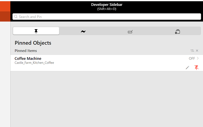

  • open the Developer Sidebar and pin all the relevant Items the the Rule will deal with
  • in another tab bring up the -Scratchpad- Script
  • in a third tab bring up my Scripts list for reference
  • start a tail on openhab.log (some may use Frontail in another tab, I use a terminal and multitail)
  • when necessary, instead of pinning the Items I’ll start streaming the events after having set filters so I only see those events I care about; sometimes I’ll bring up the stream on the -Scratchpad- tab

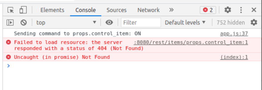

When ever something that looks like it should work is not working, open the JavaScript console. Any errors will appear there and seeing them can save you a ton of time. for example, I’m creating a list widget for my garage door openers. I’ve defined props for a sensor_item and a control_item but nothing happened when I click on it. I opened up the JavaScript console (it’ll be under Developer Tools in your browser menus) and immediately see the following error:
That immediately tells me I messed up one of my uses of the control_item, and sure enough I forgot the leading =.

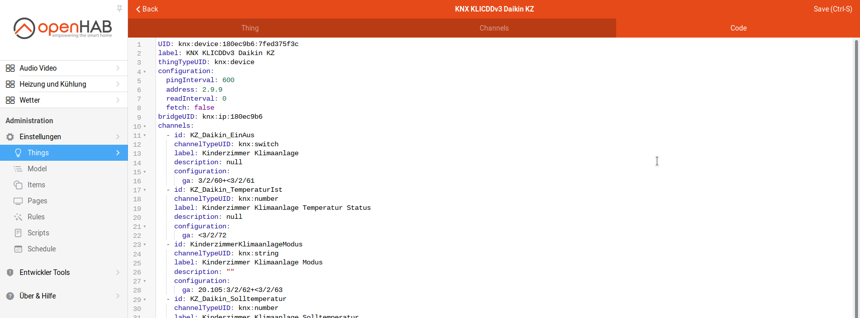

Take the time before you start and think about the modelling, it will help a lot at the end. I don’t do and have done the job several times now :wink:
I finally derive a model in textual form (per location / room) and insert it with “Add Items from Textual Definition”. I like doing it in this way because you can easily modify (not delete, but modify) a bunch of items at once later (and I do it several times now). Also thinking on a restart from scratch at some time in future will be much easier then (hopefully).
Looking into your tips my first idea is to derive (later) some useful adaptations. Searching for things in the jsondb is a hard job e.g. if you search something in a rule (because the format is not very helpful). So a search in the rules via UI would help :slight_smile:

When working with a few items from the semantic model, use the Pinned Objects in the developer sidebar so it is easy to access them without navigating the tree.

Copy things
  • Create all things via UI (only basic settings, no channels)
  • Create all channels for one specific type (e.g. HVAC, lighting, blinds) of thing
  • Go to Code of thing
  • Copy channel configuration to editor of your choice
  • Do a search and replace in the channel configuration
  • Paste channel configuration to the other things
Copy items (including metadata)
Copy items
  • Go to API Explorer Administration → Developer Tools
  • Do a GET items with itemname
  • If you want to copy multiple items, it is easier to create a group (item) first. Then enter group name as itemname
  • Supply the relevant metadata when GETTING, if you want to copy it. (e.g. stateDescripton, widget, listWidget, widgetOrder, …)
  • Copy JSON response to editor of your choice
  • Do a search and replace in the editor (keep editor open for copying metadata)
  • Do a PUT items with the JSON (metadata will not be copied in this step)
  • Check the response, if all items have been created successfully

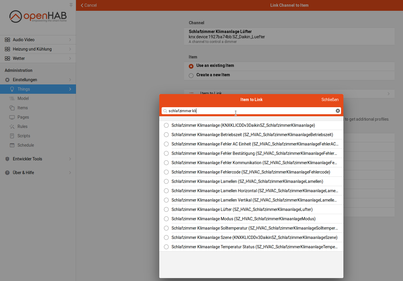

Link channels
  • Copy part of the item name to the clipboard (to be faster)
  • Link channel to items and do a paste of the item name
Best regards
Fritz
