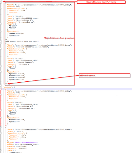

Thanks @Fritz for your great copy solution. Through this I don’t have to click 4 identical shellies, connected via mqtt, with 12 channels for each.
Only one hint for the put action, if you use a group-item.
You get all linked members in the output and can search/replace. But the PUT items action will only create the one outer item from the pasted json, not the members :frowning:
For this my workaround was:
  • copy all member objects from replaced json
  • paste it (with last comma) above of the line “members”: [
  • paste the whole json between the square brackets of the PUT items json
So you can create all items of this group with one json.
