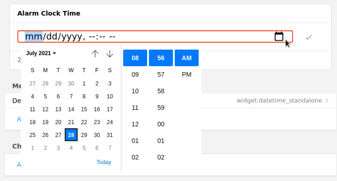

Manual Entry
If using manual entry, add the following as a custom widgets under Developer Tools. Then select the widgets as the Default Standalone Widget and Default List Widget in the AlarmClock’ Item’s metadata. See the following for more details:
Then add a rule to advance the alarm clock time to the next day at midnight which will retrigger the creation of the alarm clock timer.
For use on custom Layout Pages
uid: datetime_standalone
tags: []
props:
  parameters:
    - description: Label for the widget
      label: Label
      required: false
      type: TEXT
    - context: item
      description: An item to control
      label: Item
      required: false
      type: TEXT
  parameterGroups: []
timestamp: Jul 27, 2021, 10:06:53 AM
component: oh-input-card
  outline: true
  clearButton: false
  inputmode: text
  footer: =items[props.item].state
  item: =props.item
  placeholder: mm/dd/yyy, --:-- --
  title: =props.label
  type: datetime-local
  sendButton: true

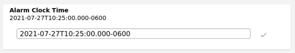

Default List Widget
For use in the Locations, Equipment, Properties, and inside List Card Widgets.
uid: datetime_list
tags: []
props:
  parameters:
    - description: Label for the wiodget
      label: Label
      required: false
      type: TEXT
    - context: item
      label: Item
      required: false
      type: TEXT
  parameterGroups: []
timestamp: Jul 28, 2021, 9:01:20 AM
  outline: true
  inputmode: datetime-local
  subtitle: =items[props.item].state
  label: =props.label
  title: =props.label
  type: text
  sendButton: true
