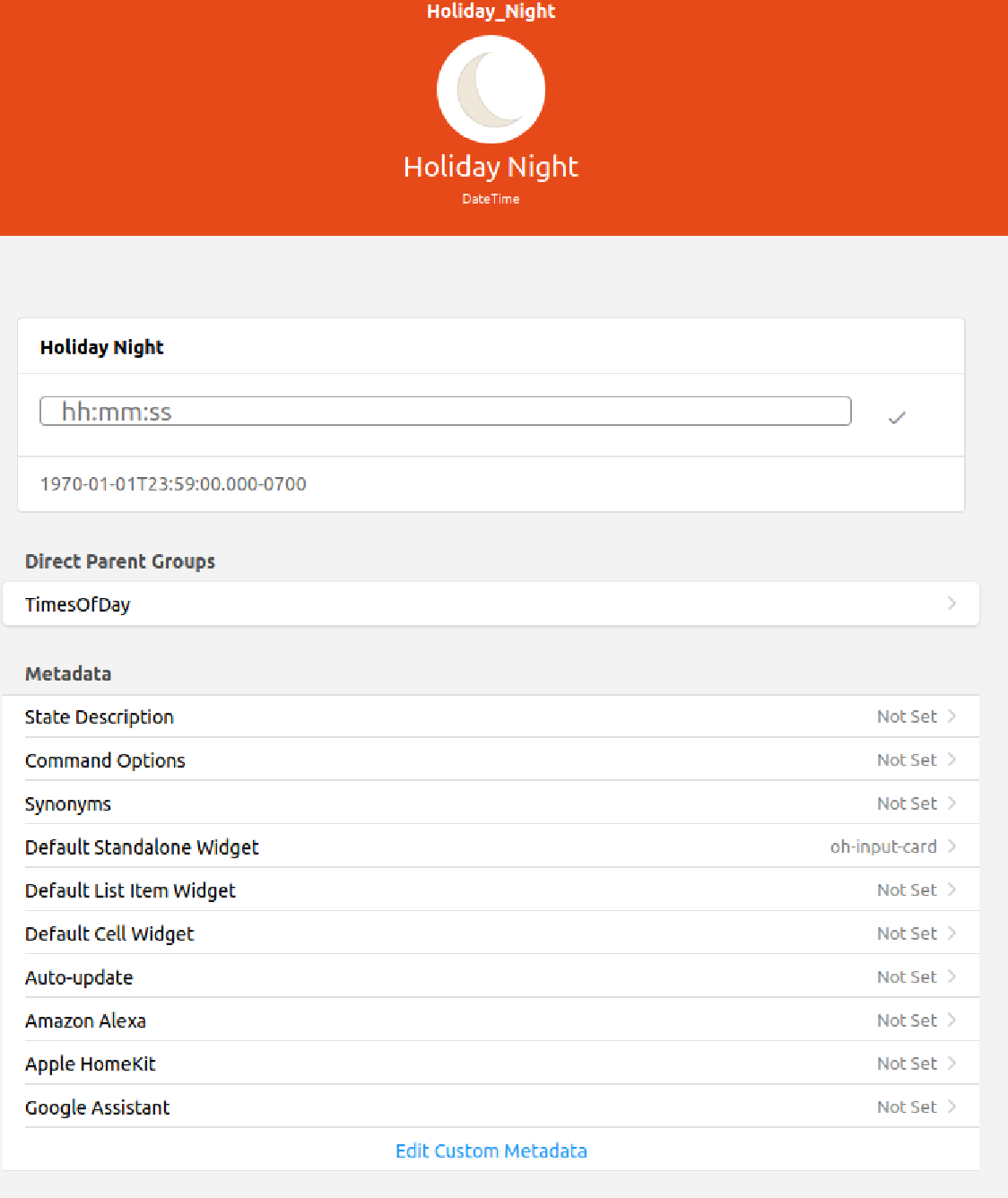

MainUI tries to create a lot of the UI for you automatically based on your Items, the Model, and Item metadata. You can influence how the Item is automatically rendered by setting default widgets on the Item. One of the places where the default widgets are used, and the place we care about here, is on the Item’s page itself.

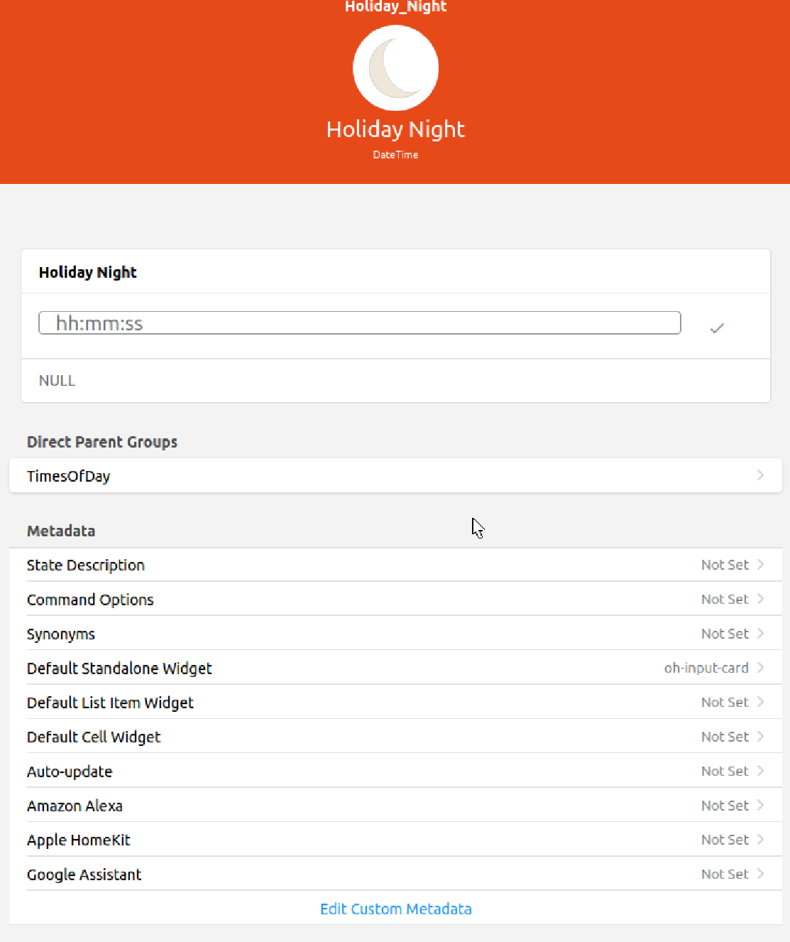

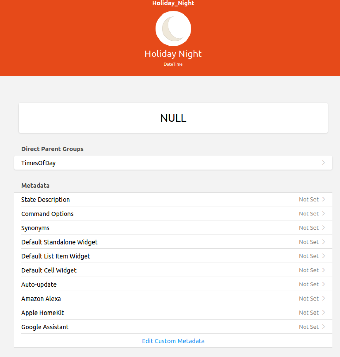

In the above you will see I have a DateTime Item named Holiday_Night. It doesn’t have a state yet (notice the NULL). So where does that “NULL” come from anyway? Can I change how that widget is rendered? The answer is “yes!” That is the “Default Standalone Widget” which you will find near the middle of the list of predefined metadata entries.

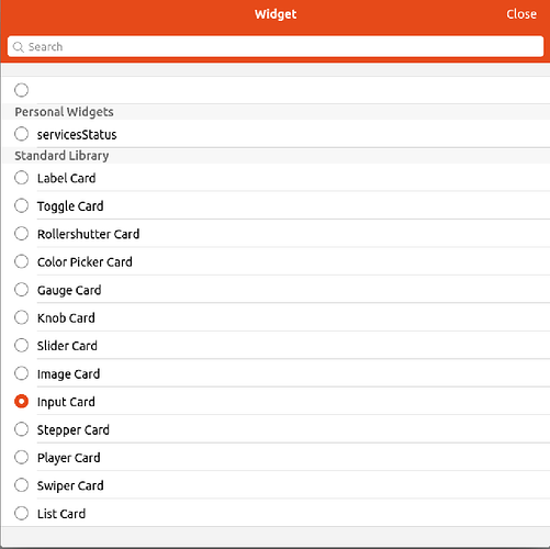

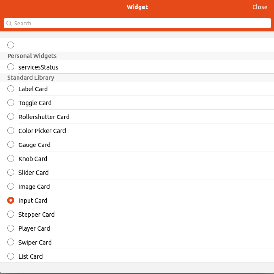

Click on that and you will be presented with a preview of the widget and a menu Item to select what sort of widget you want to use as the default.
Click on “Widget” and select “Input Widget.” If the Item were of another type you can choose the appropriate widget for that type (e.g. a knob for a thermostat setting).

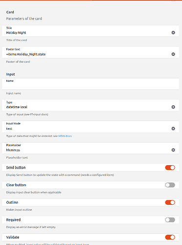

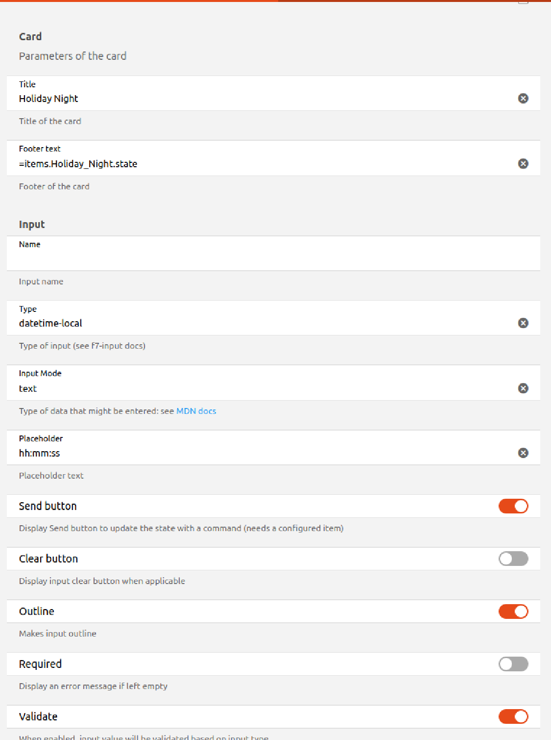

This opens up a form where you can start to customize the widget. In our case we will set:
  • title: Holiday Night
  • footer: =items.Holiday_Night.state
  • input type: datetime-local
  • input mode: text
  • placeholder: hh:mm:ss
  • send button: toggled on
  • outline: toggled on
  • validate: toggled on
NOTE: input mode defaults to text so that isn’t really needed. The placeholder is a reminder of what to enter. For time of day we don’t care about the date so only the time needs to be entered using 24 hour time. Starting any field with = starts a formula where you can calculate the state based on Item’s state. In this case we just use the state. The javascript ternary operator (condition) ? true value : false value comes in handy here.

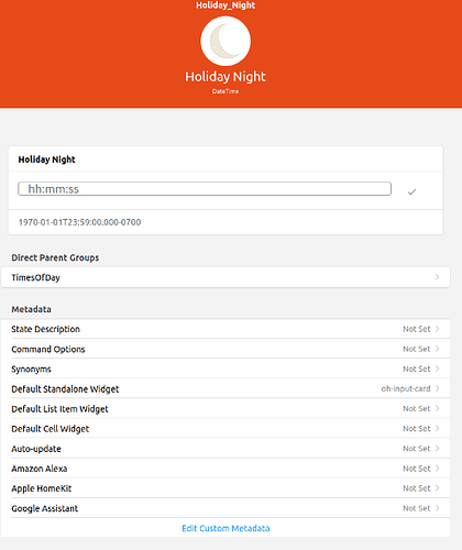

You will see you changes rendered in the preview at the top. Click save and you will see a live view.
Enter the time you want to initialize the Item with and click the checkmark to the right and the Item will be updated to that time. You will then see the Item’s new state in the footer of the card.

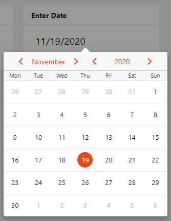

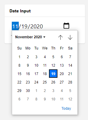

Not really :slight_smile: You can specify “date”, “time” (native controls) or even “datepicker” (Framework7 calendar) as the type in the input widget’s parameters (need a list of options for those), but I don’t think they will output dates in a format accepted by DateTime items by default…
Turns out, it doesn’t work too bad, except the time picker doesn’t parse the full date properly - but setting the time works.
If you use datepicker as the type, you have a calendarParams (or calendar-params, see Input Vue f7 docs) and then you can set the calendar options) as you like. Not easy, but it works.
Here’s an example with:

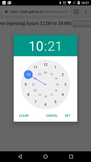

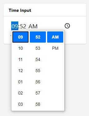

That heavily depends on your browser and OS. Mozilla has a comprehensive page on that: <input type="time"> - HTML | MDN
So it could be bare bones or way fancier, for instance here’s how it should look on Android:
Definitely. That’s what I tried to say with:
