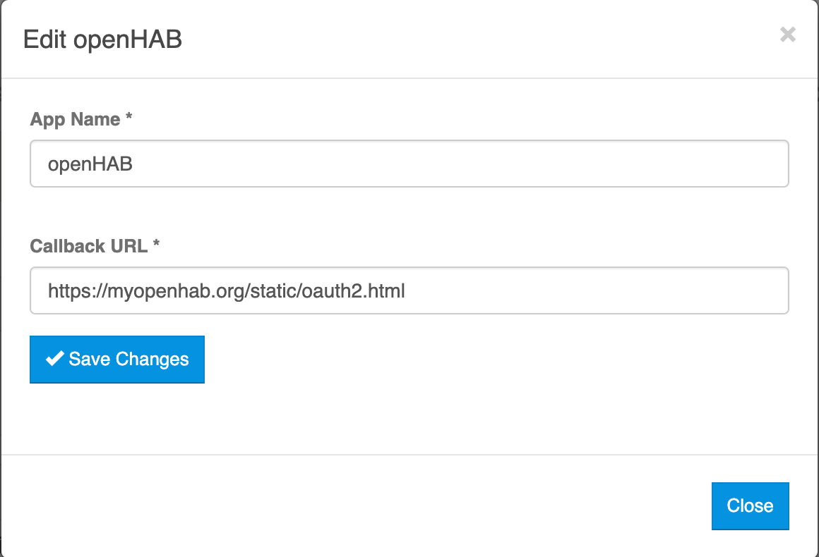

Once logged in click on “Create new APP” with what ever name you want to give it.
Make the “Callback URL” be https://myopenhab.org/static/oauth2.html. If you have exposed your OH to the internet, use that URL instead. We will populate the oauth2.html file in the next step.
Once created the app should be approved and you will have a Consumer Key and Consumer Secret. We will need these later.
That’s all we need to do on the Honeywell side.
