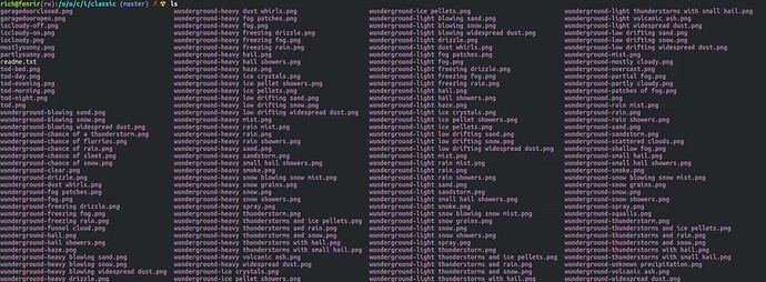

Icons
Wunderground provides ten sets of conditions icons. Unfortunately, they are in gif format and I couldn’t find any licensing information. So I’m afraid you will have to go through the tedious process of converting these icons into png or svg and creating a version of each to cover all of the possible conditions (the weather.map file below will help).
Brute Force
The procedure I followed was to right click to download the icon files and copied them to conf/icons/classic. I used the mogrify command line utility (comes with Ubuntu 17, ymmv) to convert them into png files. I don’t know if mogrify supports svg. The full command I used was:
Then I started the tedious process of creating all the dynamic icons versions for all the Wundergound conditions. And I’m certain I haven’t covered them all yet, particularly for the forecast conditions like “Chance of Rain” and such.
Make sure to create a default wunderground.png which will be chosen when no other icon matches. I made a copy of the error icon from the default OH icon set.
Then make a copy of the desired icon for each condition listed in weather.map below. Copy over all of the “Chance of” icons to a wunderground version. For example “chancesnow.png” would be copied to wunderground-chance\ of\ snow.png. Note that the icon must be all lower case. Use escaped spaces in the names for Conditions that include spaces (which is almost all of them). You will end up with a list of icons that looks something like:

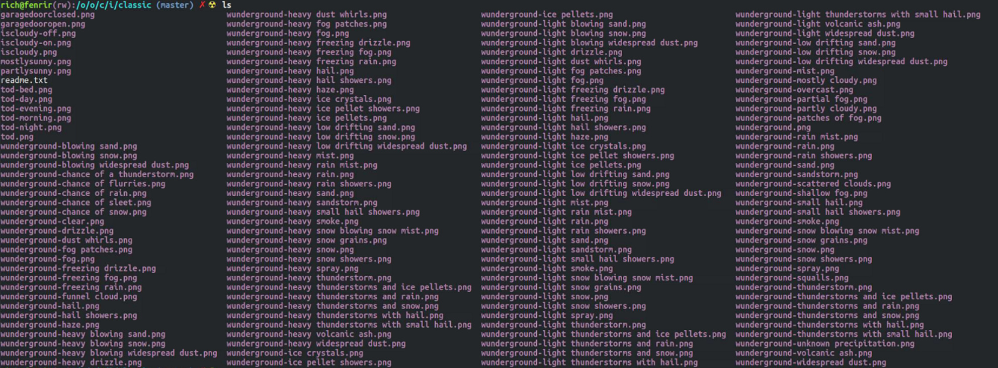

Cached (PREFERRED)
A third approach that works even within the Docker is to pre-download the iconset from wunderground and then use a Rules to copy the icons to the proper filename as they are needed.
This time place the icons that have been converted from gif to png in an out of the way folder. I chose conf/icons/classic/wunderground. Leave their names unchanged.

It occurred to me one could also save the icon to a wunderground-current\ conditions.png file and make the rule a little smarter to not retrieve and replace the file if it already exists. Fetching the icons doesn’t count against your API limit but you may want to lower the network traffic anyway.
Yet another approach would be to split the difference.
  1. Download all the icons and convert them to png or gif as above and put them in your icons/classic folder
  2. In the rules above, instead of doing a wget, copy the wunderground supplied named icon to the full text of the condition named file that OH needs. This will work even in the Dockerized case because the cp command is always there. :slight_smile:
More to follow…
