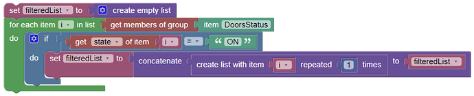

  • : Puts a list of all the members of MyGroup that have the state ‘ON’ into the variable filteredList.

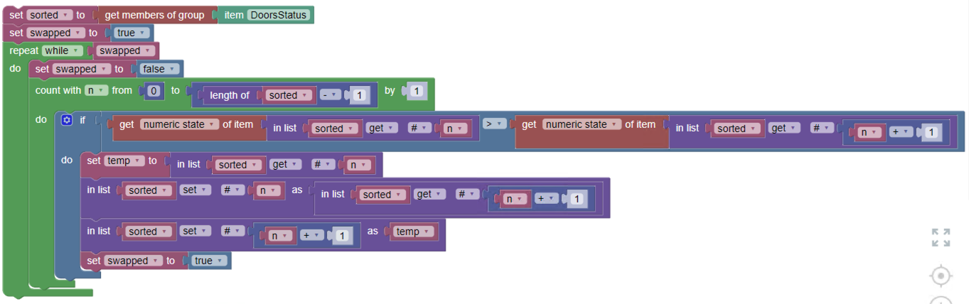

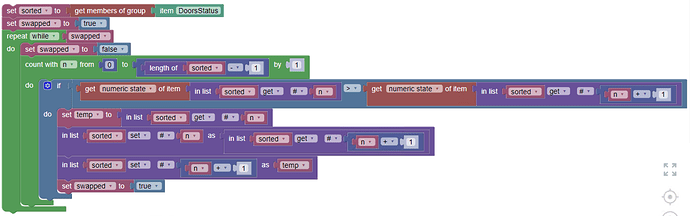

  • : Sorts the list of Items based on the Item’s numeric state (the sharp eyed among you may recognize the bubble sort algorithm). Note this is an in place sort and does not create a new list. (Note the existing sort block only works on numbers and strings, not Objects)

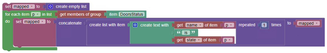

  • : Sets mapped to a list containing a string for each Item that is the “Item’s label is state” (e.g. “MyItem is ON”)

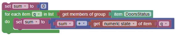

  • : Sums up the states of all members of MyGroup and stores it in the variable sum.

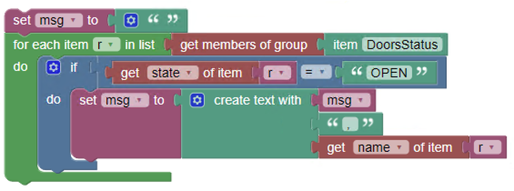

Combining some of the above, let’s build a String showing all the doors that are open:
