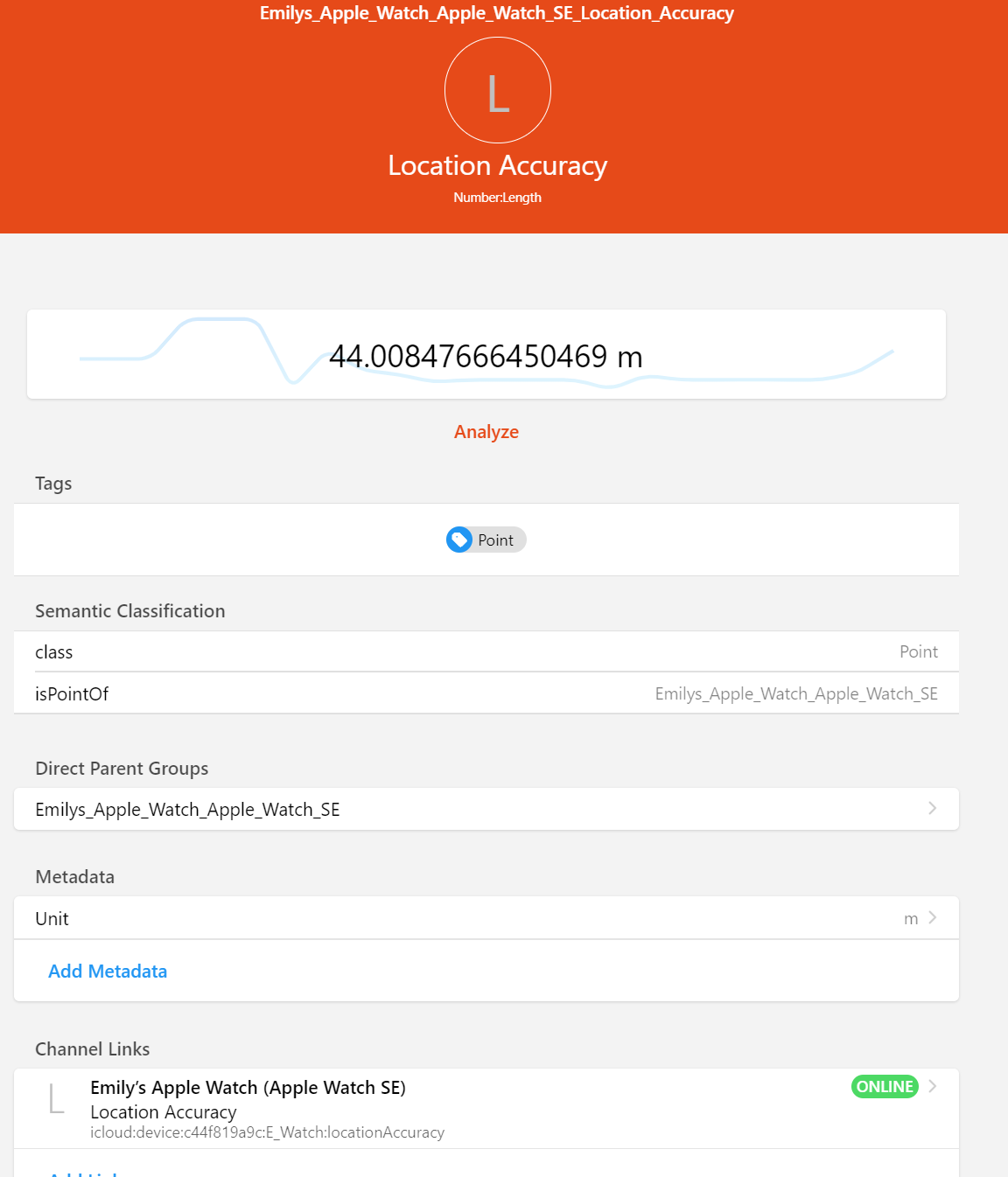

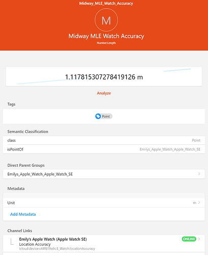

The old Item, to which I had added the Unit metadata “m” works as expected. The new Item that I created using the “Add Items from Textual Definition” Developer Tool included {Unit=“m”}, appears to be treating the channel input as inches (default for my locale) and converting it to the unit specified in the metadata.
From the UI Channel view of the Thing:
The Items looks the same:
Old:
New:
In the events log, it is clear that the new one is thinking in inches:
2023-08-27 08:33:48.534 [INFO ] [openhab.event.ItemStateChangedEvent ] - Item 'Midway_MLE_Watch_Accuracy' changed from 12.156181357471018 in to 44.00847666450469 in
2023-08-27 08:38:49.784 [INFO ] [openhab.event.ItemStateChangedEvent ] - Item 'Emilys_Apple_Watch_Apple_Watch_SE_Location_Accuracy' changed from 44.00847666450469 m to 12.156181357471018 m

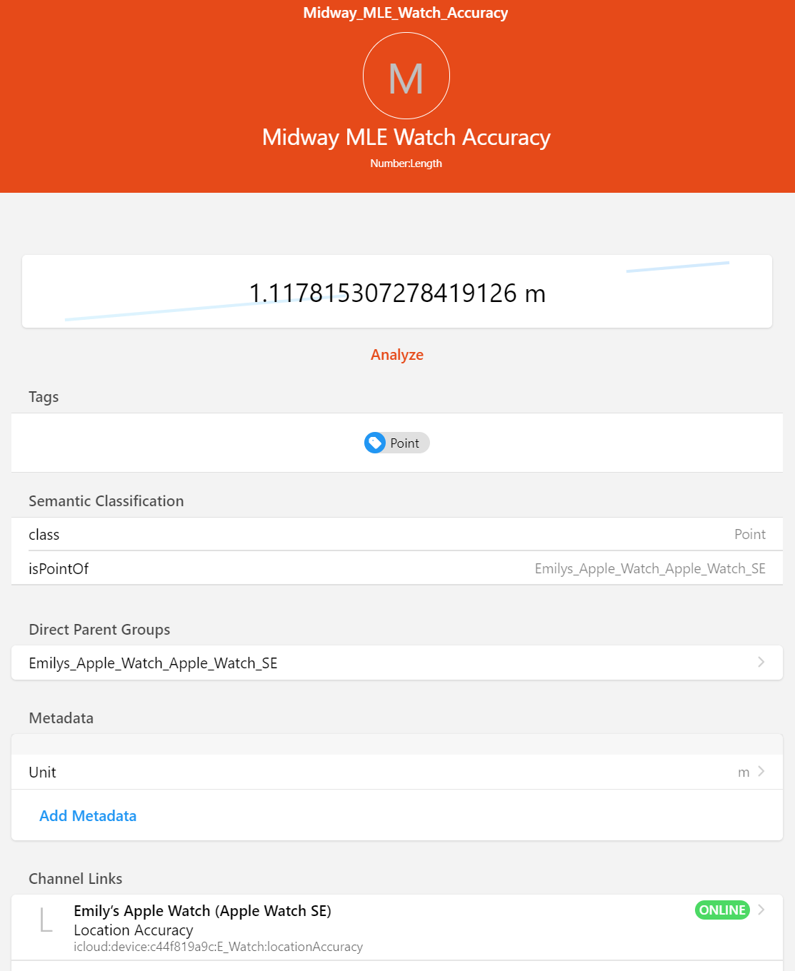

I created a new Item using the UI “Add Link to Item”, create a new item. I created it as the default Number item. It displayed the same number as the old item, but without the unit. Then I edited the Item and changed the Type to Number:Length, and added Unit metadata “m”. At first it displayed the same number and unit as the new item, but after the next update from the channel, it displayed the same number and unit as the old item (and which is the correct data).
Based on the above, I tried changing the new Item type to Number. It immediately displayed the same number as the old item, but without units. I couldn’t figure out how to remove the Unit metadata. I then edited it again back to Number:Length. Unfortunately, it returned to the original behavior and is treating the channel input as inches and converted it to meters.

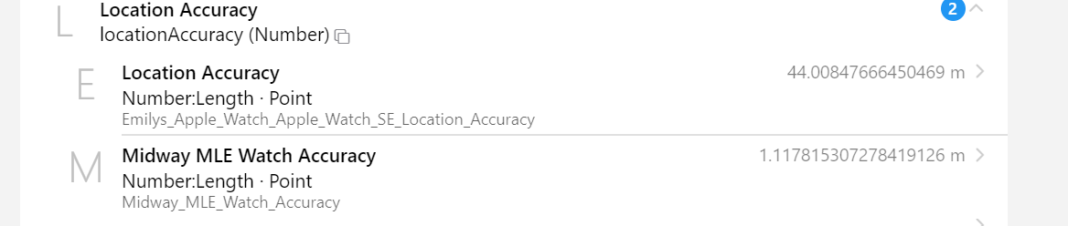

Not completely sure what to show about the channel, but this is what it shows when trying to link a new item.
The iCloud Binding documentation for this channel lists:
Channel ID Type Description
locationAccuracy Number Accuracy of the last position report (Advanced Option on UI)
