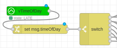

I keep this script that determines vTimeOfDay in OpenHAB rules, but I do almost all of my rules in NodeRED, where I watch for vTimeOfDay changes.
In NodeRED a sample flow looks like this:
Where the change node does msg.timeOfDay = msg.payload, and the switch node is obviously a switch based on msg.timeOfDay.
Why I didn’t do it all in NodeRED? Because I think the table is quicker to see/edit in OpenHAB, but this code could be in there as well in a subflow.
