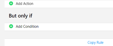

In MainUI the conditions can be found near the bottom of the rule’s page.

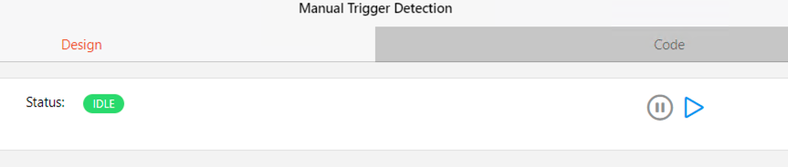

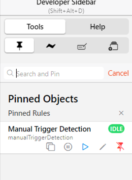

On the rules page and from the developer sidebar there is a pause button (circle with an 11 in the middle next to the triangular play button). Clicking this causes the rule to be disabled.

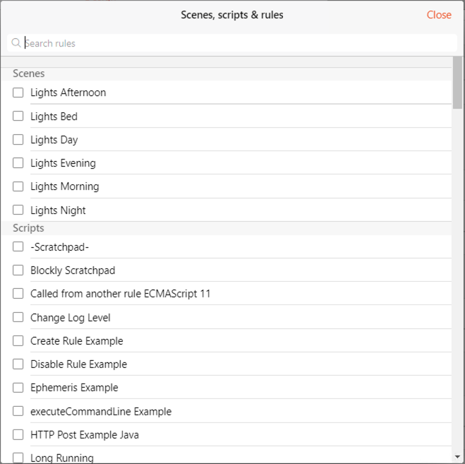

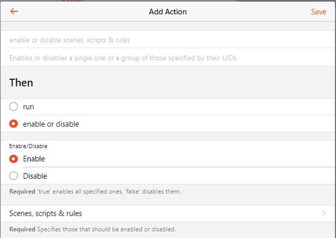

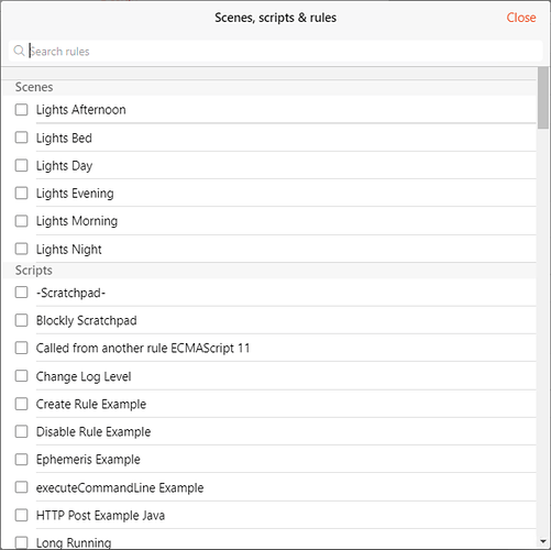

When adding an action to a rule the “Scenes, Scripts & Rules” option has as a choice enabling or disabling a rule.
Any number of rules can be disabled in one action.
