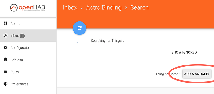

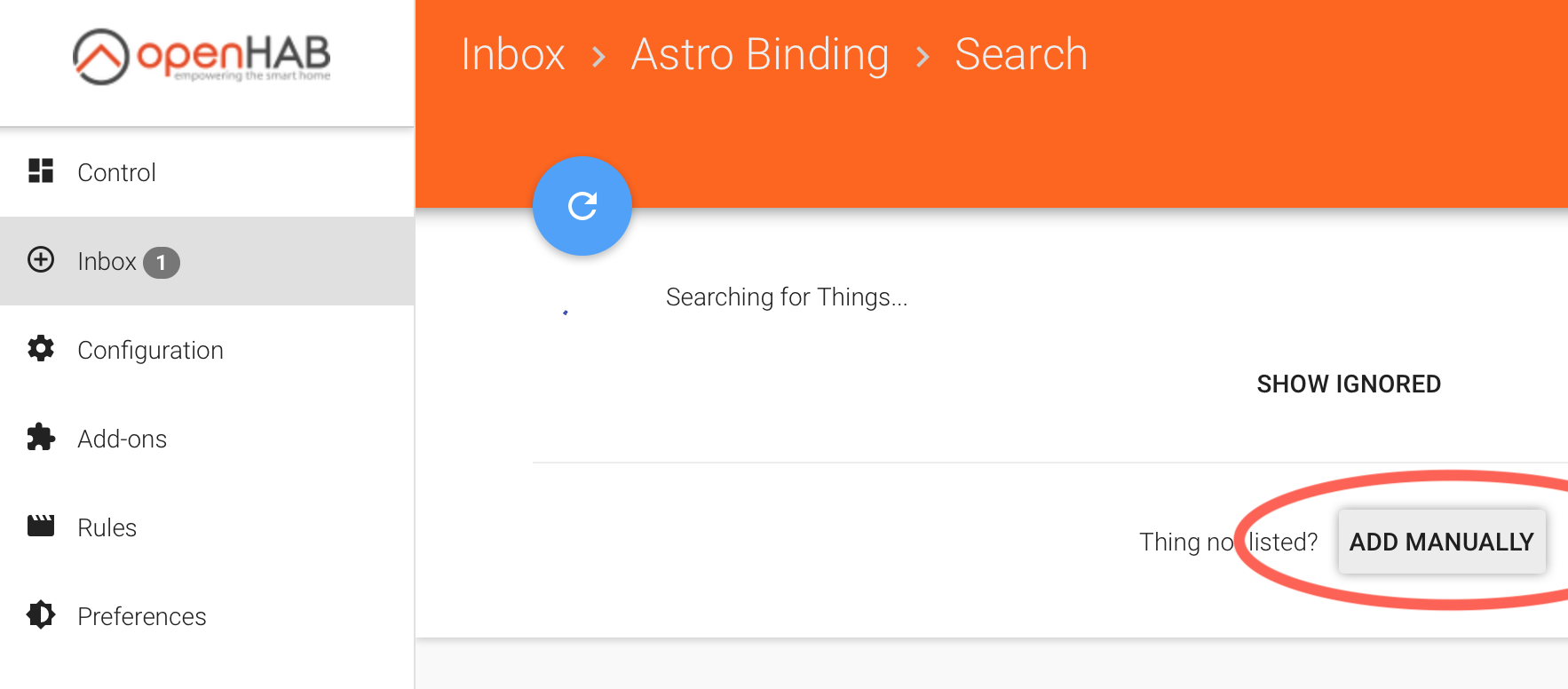

In the Inbox press the + button and select Astro front the list. Populate with the appropriate information from there.
I’m going from memory here so I might have missed a step but this should get you close.
To add Astro Things in Paper UI go to Configuration > Things then hit “+” and choose “Astro Binding”, then “ADD MANUALLY”.

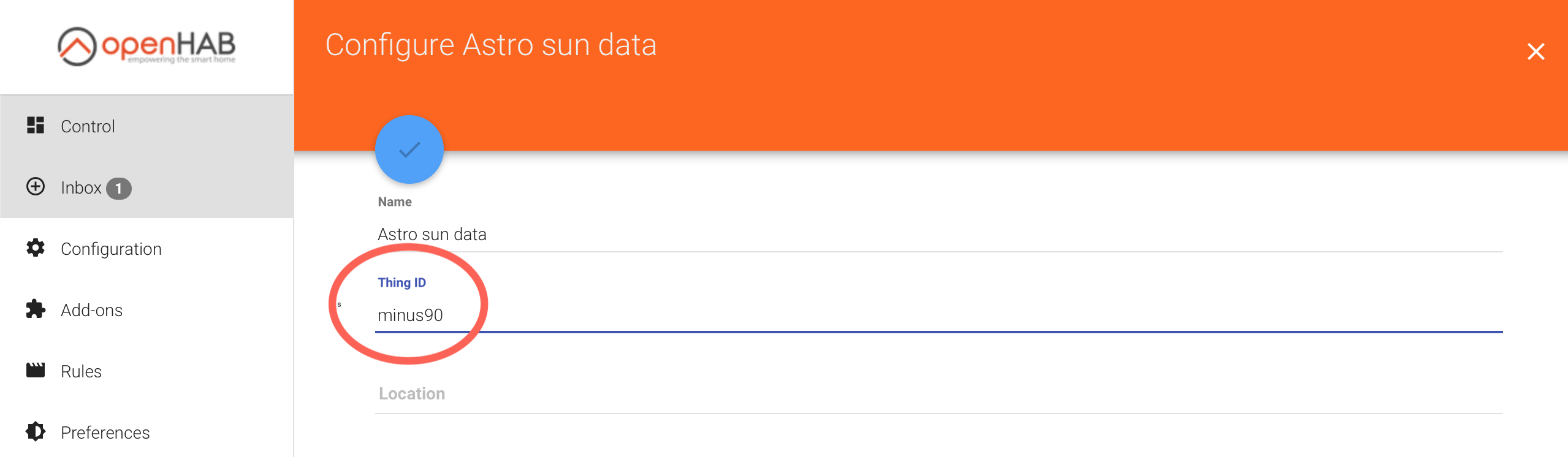

Set “Thing ID” as shown in the screenshot.

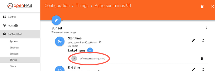

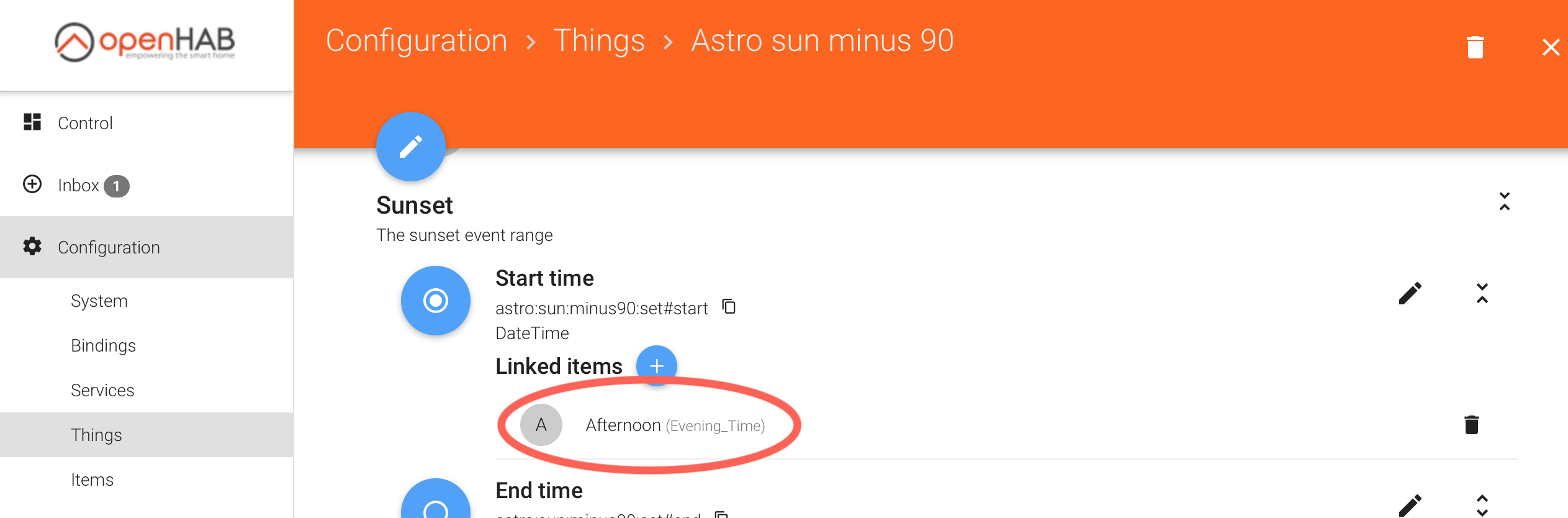

Finally set linked channel to “Evening_Time”.
