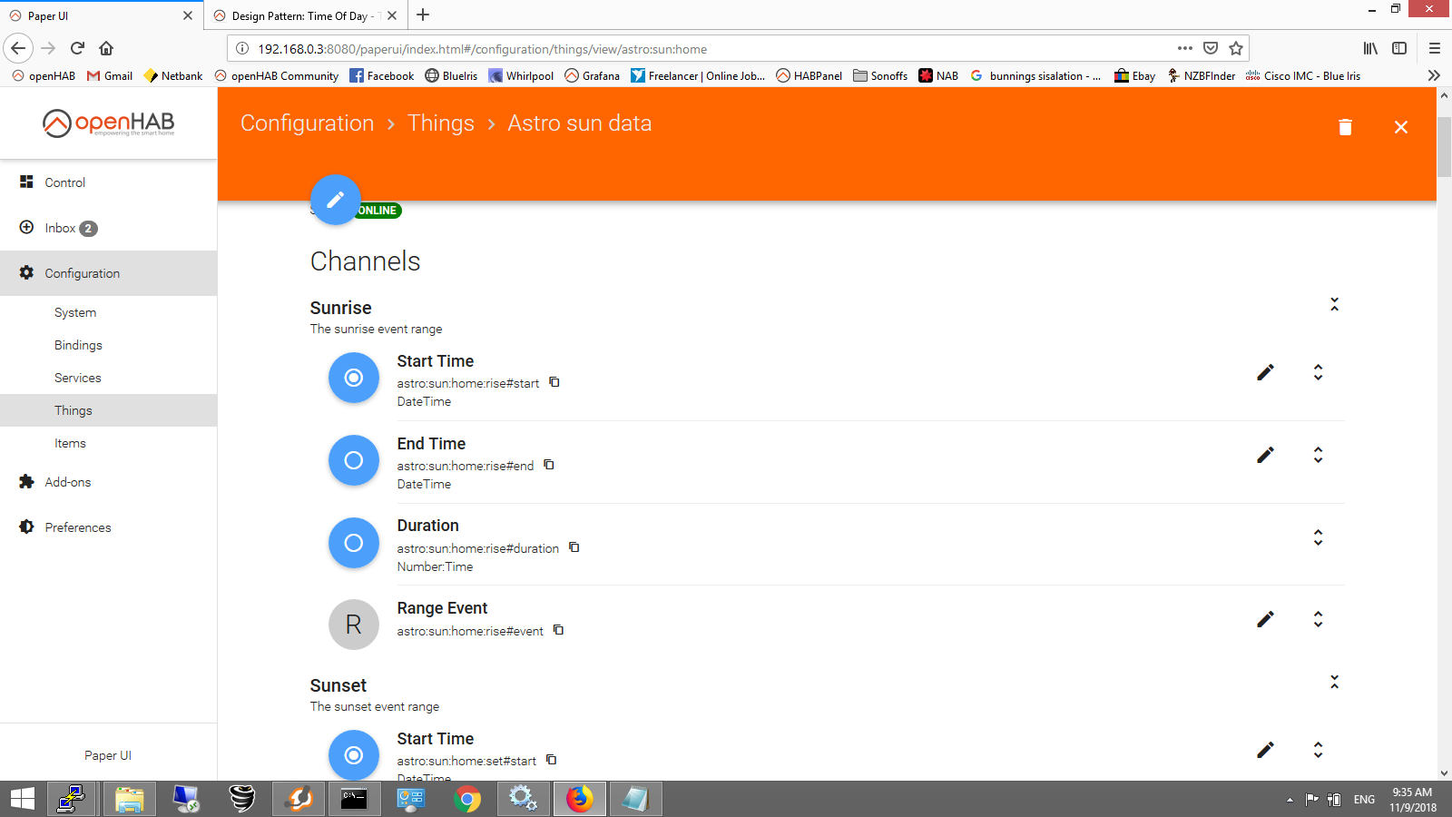

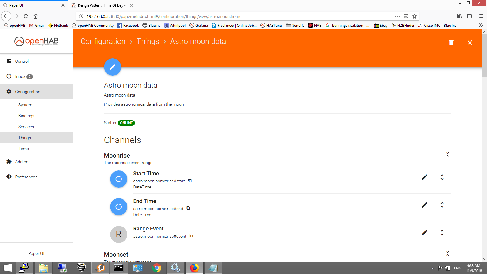

Your Astro Thing IDs match?
Note there are two Things, one names astro:sun:home and astro:sun:minus90. By default I think OH creates a Thing names astro:sun:local so you need to create these two Things.
What version of OH are you running? If you are not seeing at least “Calculating time of day…” in the log then the Rule isn’t triggering which means the System started trigger is not working.

Ill check the thing ID
See attached…looks like they match
It might work when one of the times in the tirggers occurs, but the fact that it isn’t triggering on System started is a problem and not one I’ll be able to help with. I think I saw a posting that yesterday’s build broke System started triggers but I might be mistaken.
Do you have any other System started rules? Do you have any Thread::sleeps in any of them? These used to cause problems.
But ultimately vTimeOfDay isn’t getting set because the Rule is never running.
