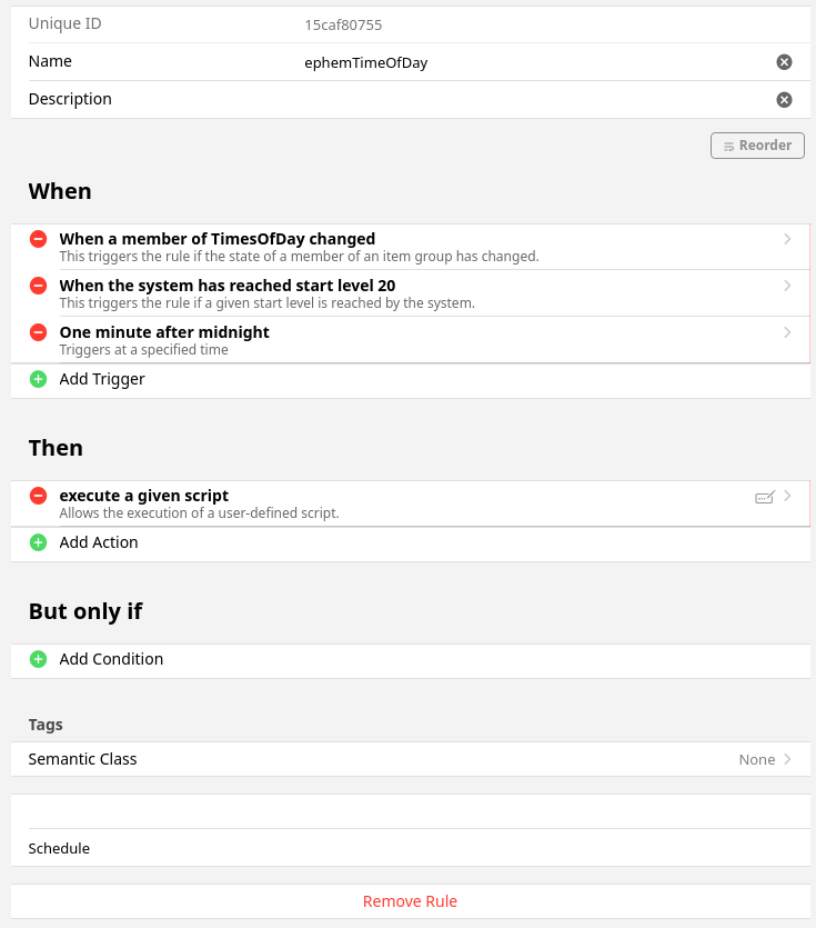

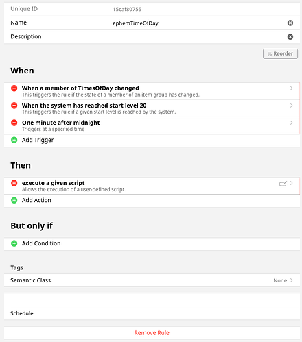

I have imported ephemTimeOfDay.yml as the rule, and if i manually run it the ‘TimeOfDay’ changes correctly. How can i make ephemTimeOfDay rule run all the time.
The OP says “Switch back to the design tab and set a “Schedule” tag and the rule will show up in the calendar under Schedule”. I tried to add a schedule tag at the bottom of the rule like the screenshot below, but it doesnt get saved.
How can i make this rule to work in the background?
Ok, i can see from the log that TimeOfDay is changing. However, the schedule comment is above is still not clear.

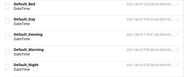

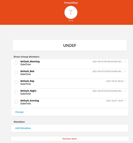

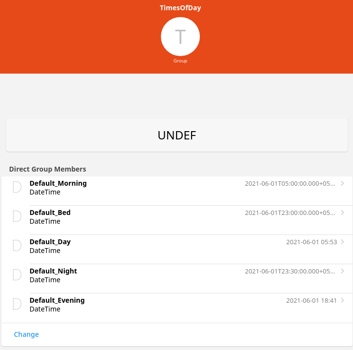

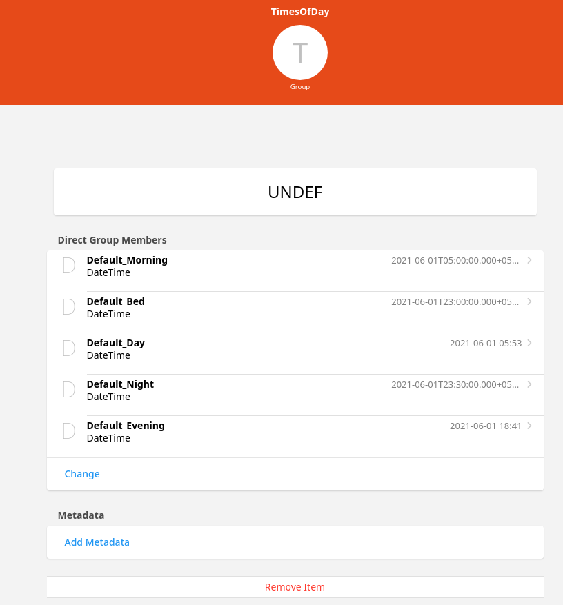

This is what TimesOfDay group shows for its members,
Any idea why the rule became Day at midnight when the Default_Day is supposed to start at 05:53am?
No rules run “all the time.” They run in response to the events defined under “When”. In this case it runs when OH first starts up, one minute after midnight, and when any member of TimesOfDay change state.
Once entered you need ot hit <enter>. Then it will show up in the space above where you typed in a blue oval.
Why do the datetimes for Default_Day and Default_Evening appear different from the other three? That could be a clue, particularly if those are being shown as times in a different time zone.
What was the time of day immediately before the rule ran at midnight?
Thanks, that did the trick.

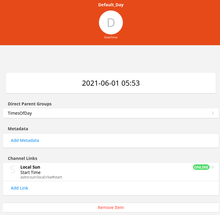

The log doesnt have the TimeOfDay before midnight. The items on their own show the full datetime string with TimeZone, however in a group they show up differently.
The timezone is consistent in the item definitions. The Default_Day item is linked to Astro binding and it doesnt show the timezone.

Bindings can supply default state descriptions to linked Items; there’s probably nothing sinister about different display formats for linked against unlinked Items.
If you needed a pretty user-facing UI display, you’d probably set your own Item state descriptions anyway.
