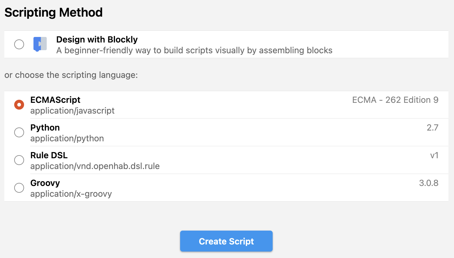

How do i select using the “default JavaScript”? When creating a script or rule i only have these options:
I tried the Blockly option where i switched to the code view and pasted the code and the ECMAScript option as well…
It appears that if you’ve installed the GraalVM JavaScript addon it replaces the default one. In other words, you can’t. If you do not plan on using the GraalVM JavaScript, don’t install it. If you do plan on using it you’ll have to rewrite the rule above to work with that.
