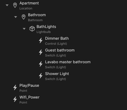

My model now looks like this.
The overview page is now completely empty.

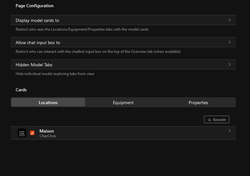

My question was not correctly phrased: it’s precisely the Locations, Equipements and Properties that stay empty on the default page. When I edit them, I see the list of cards as they are defined in my model; so it looks all fine to me. But they are not visible on the tabs. I don’t see anything wrong in the logfiles either.
Could you please post some screenshots.
This is what I see when I edit my page:

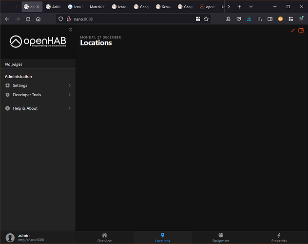

This is the result:
As you can see, the Locations tab is empty.

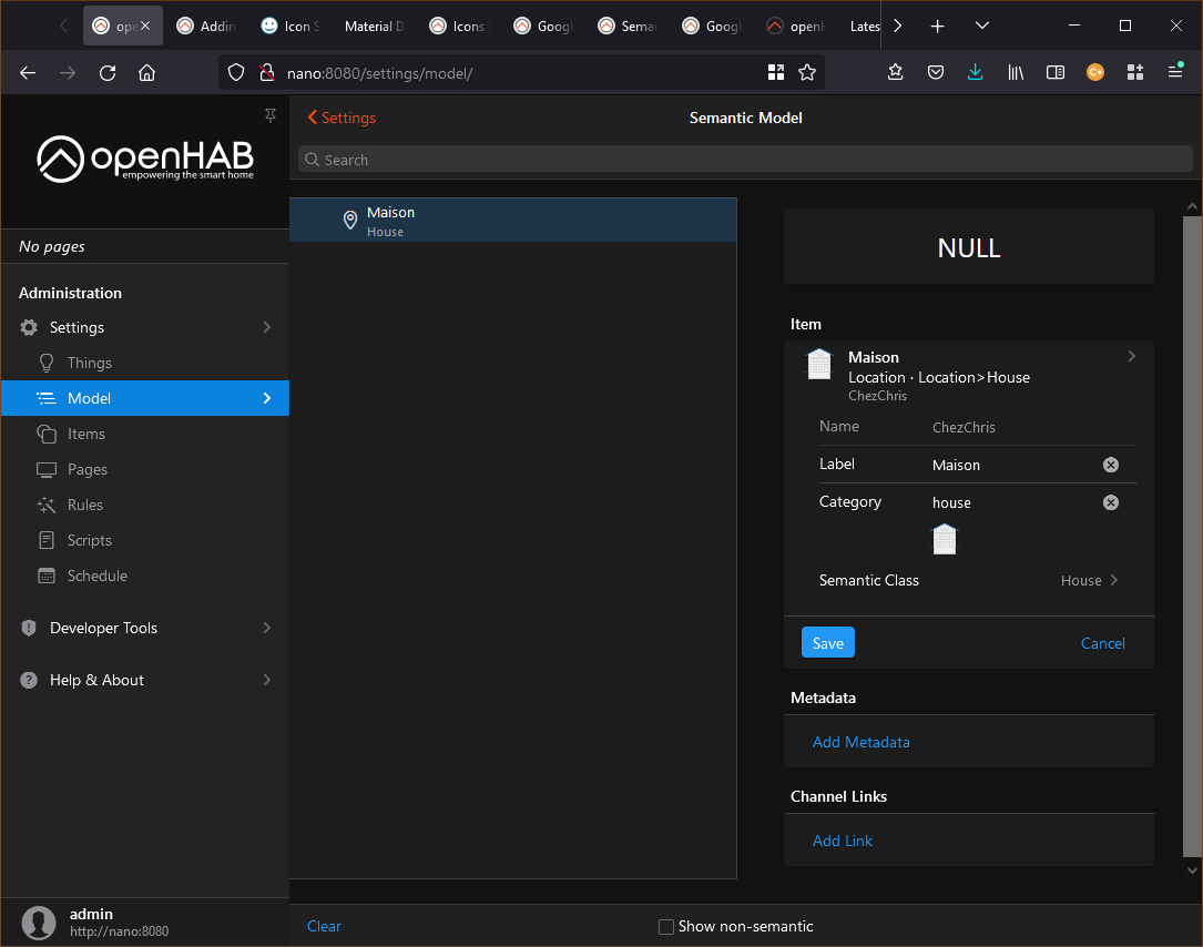

Well, we need to see your semantic moddel to identify the issue…
Your semantic definition is incorrect, it needs to be Group → Location → House …
I’m confused. 3 levels? Here is the closest I get for Group => Location => House:
Or this:
Both do not work.
Gosh, they are both the same :smiley:
Sorry, had to be a bit clearer.

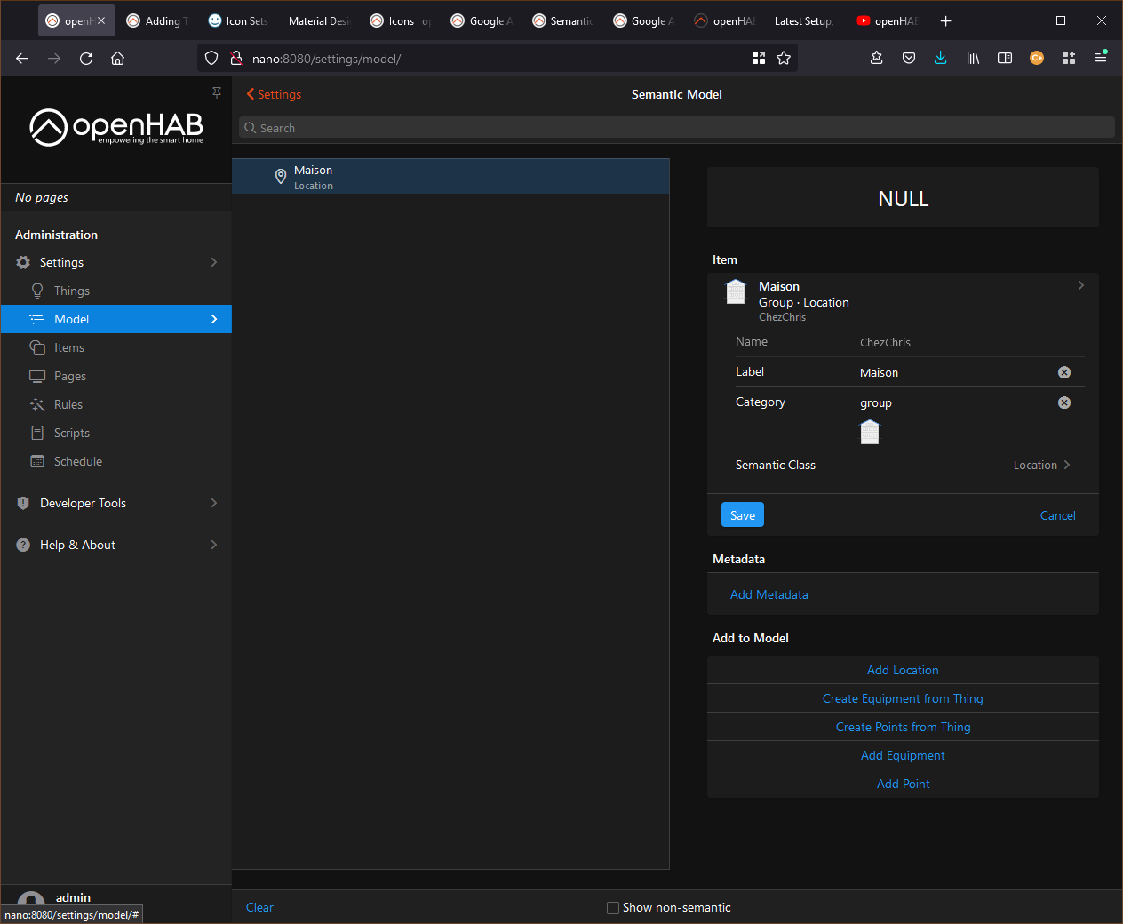

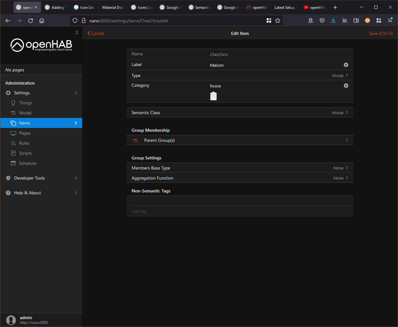

If you edit your Item, you should see a Type field, which needs to be set to Group.
Then under Semantic Class Select House.
If you than check the Item you should see it as Group → Location → House.

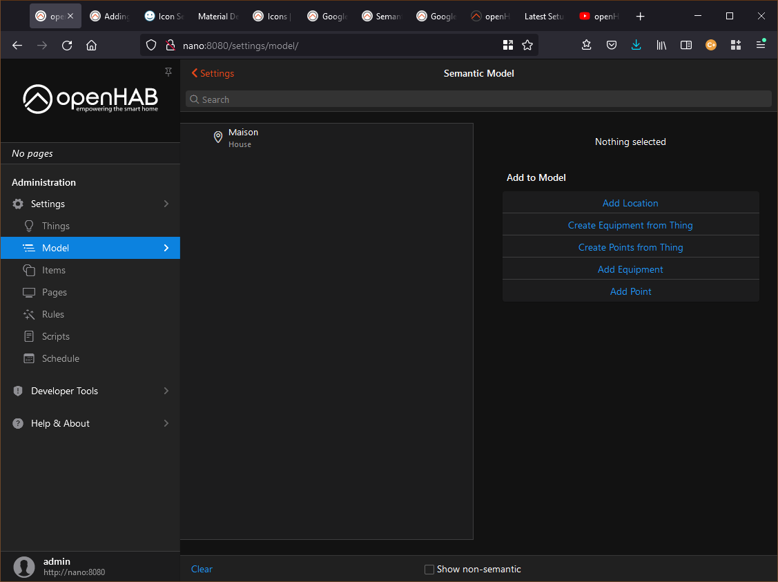

Editing item:
After editing I see Group => Location => House:

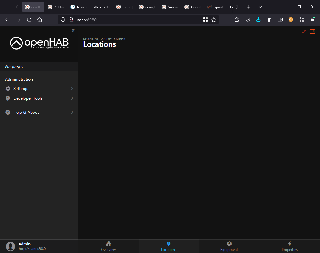

Still nothing on the Locations tab.
It might be that it needs at least on semantically tagged Item belonging to that group to show up.
Please create an equipment belonging to that group.
