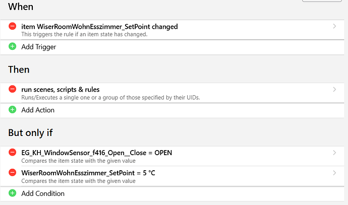

I am currently trying to create a rule that resets an update of the target temperature when the window is open.
IF Setpoint is chancing and Window is open
THEN RUN script to reduce tempertur to 5°C
I tried it like this but the condition ‘2’ of rule is unsatisfied.
Is this related to the Quanity type?
The second condition would only be satisfied when the Setpoint == 5 °C.

It seems you have all the parts of the rule confused.
When
These are the events that happen to cause the rule to run, the trigger. In your text that is “IF Setpoint changed and window is open”. I would expect the rule to be triggered by both the Setpoint Item and the Window Item (the window can open after the setpoint is changed, right?)
Then
This is what to do when the rule runs and the conditions are all true. In your text version of the rule this should be something along the lines of “send command to Item WiserRoomWohnEsszimmer_SetPoint to 5 °C”. I can’t tell what your action does because this is just a screen shot. You don’t need a Script Action to do this though.
But only if
These are all the conditions that must be true for the rule to run the actions (i.e. the stuff under Then) when the rule triggers (see When). In your text that’s “Window is open” so I would expect to see the window Item listed there and nothing else. You have no other conditions in your text description of what you want the rule to do.
So it should be:
When
  • item WiserRoomWohnEsszimmer_SetPoint changed
  • item EG_KH_WindowSensor_f416_Open__Close changed to OPEN
    Then
  • send command to item WiserRoomWohnEsszimmer_SetPoint to 5 °C
    But only if
  • EG_KH_WindowSensor_f416_Open__Close = OPEN
  • WiserRoomWohnEsszimmer_SetPoint != 5 °C
The last condition is to avoid running the rule again when it’s commanded to 5 °C or it’s already 5 °C.
Yes. You are right. The operation must be !=.
I changed it. But its the same “condition ‘2’ of rule is unsatisfied.”.
Without the code to see which one of those conditions is 2 :man_shrugging:
The IDs count up as you add anything to the rule so which one is 2 depends on when you added the conditions and actions.
autocode
configuration: {}
triggers:
  - id: "1"
    configuration:
      itemName: WiserRoomWohnEsszimmer_SetPoint
conditions:
  - inputs: {}
    configuration:
      itemName: EG_KH_WindowSensor_f416_Open__Close
      state: OPEN
      operator: =
    type: core.ItemStateCondition
  - inputs: {}
    configuration:
      state: "'5 °C'"
      operator: "!="
actions:
  - inputs: {}
    configuration:
      considerConditions: true
      ruleUIDs:
        - 85daadbb84
    type: core.RunRuleAction
OK, so it’s the Window sensor condition that is condition 2. So I guess the window isn’t open? What is saying it’s unsatisfied? Normally it doesn’t log that out.
