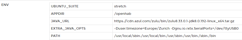

How did you pass the EXTRA_JAVA_OPTS to the container?
over the ENV option:
It looks good to me! Maybe @TimO can help?
