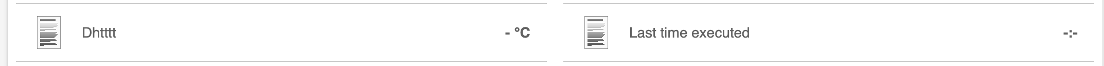

Today connected DHT22 temp & humidity sensor and get readings via ssh on openhabian.
But I can not get readings in sitemap. Exec binding installed, on beginning I had and issue with whitelist but solved by adding command to the list. Command itself checked via ssh.
Thing:
Thing exec:command:dht [command="/usr/bin/python3 /home/fox/mydht2.py", interval=15, transform="REGEX((.*?))", autorun=true]
Item:
String Dht11 "[%.1f °C]" {channel="exec:command:dht:output"}
Sitemap:
Text item=Dht11 label="Dhtttt [%.1f °C]"
Added also last execution to check but also nothing appear
DateTime Dht111 "Last time executed [%1$tH:%1$tM]" {channel="exec:command:dht:lastexecution"}
I’m beginner so MQTT a little bit complicated for me - I would like to access that readings with simplest method. Spent all day reading posts but I can not figure out what’s wrong.

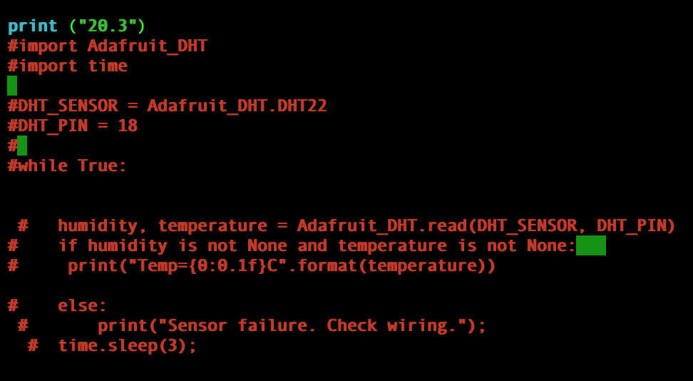

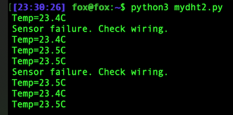

  • does the openhab user ( the user the openhab java process is running under ) have read access to /home/fox/mydht2.py ?
  • your python script seems to run in an endless loop; I would suggest to make it returning a single value
  • in first step use a script that emulates your script and returns a single ( random ) value; once that works continue using your script that reads from GPIO

  • I have no idea how to check read access for openhab user

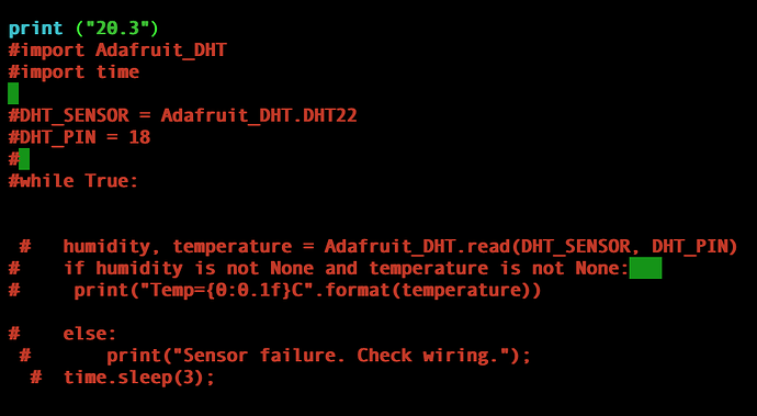

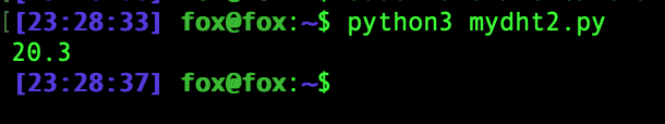

  • I changed my .py script, now looks like that
print ("20.3")
Via ssh return single value

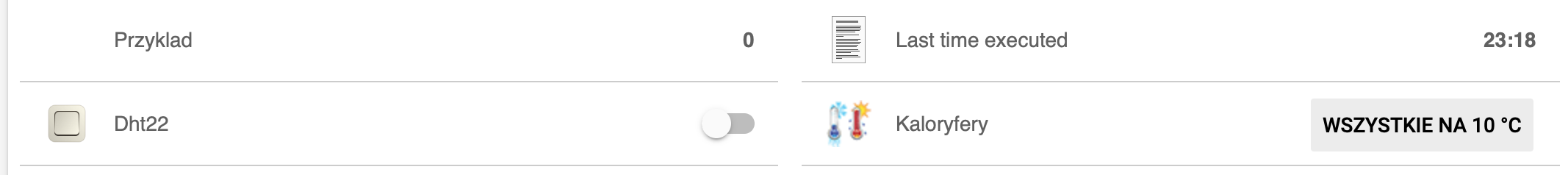

That all above changed results:
Now I have reading - but “0”.
items
Switch Dht22 {channel="exec:command:dht:run"}
thing
```Thing exec:command:dht [command="/usr/bin/python3 /home/fox/mydht2.py", interval=15, transform="REGEX((.*?))", autorun=true]
sitemap
``` Text item=Dht11 label="Przyklad [%.0f]"
        Text item=Dht111
        Switch item=Dht22
So after script change something changed in sitemap but still no expected results??? Which script can be more simple?
I would suggest to modify the python script and update the item via REST API with your required frequency. I”m using the same method with a Wemos and a DS18B20. Another method is updating via mqtt.
Make the item in the sitemap:
Text item=Dht11 label="Przyklad [%s °C]"
and the item itself:
String Dht11 "[%s °C]" {channel="exec:command:dht:output"}
then you will see the values.
I was not able to format them as Number. According to other thread it looks like others have the same problem so it seems to be a bug.
Thank You Wolfgang_S :slight_smile:

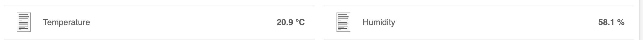

things:
Thing exec:command:dht [command="/usr/bin/python3 /home/fox/mydht2.py", interval=30, transform="REGEX((.*?))", autorun=true]
    Thing exec:command:dht3 [command="/usr/bin/python3 /home/fox/mydht3.py", interval=10, transform="REGEX((.*?))", autorun=true]
items:
String Dht11 "Temperature [%s °C]"  {channel="exec:command:dht:output"}
String Dht33 "Humidity [%s %%]"     {channel="exec:command:dht3:output"}
sitemaps:
Text item=Dht11 label="Temperature [%s °C]"
Text item=Dht33 label="Humidity [%s %%]"

Now working :grinning:
