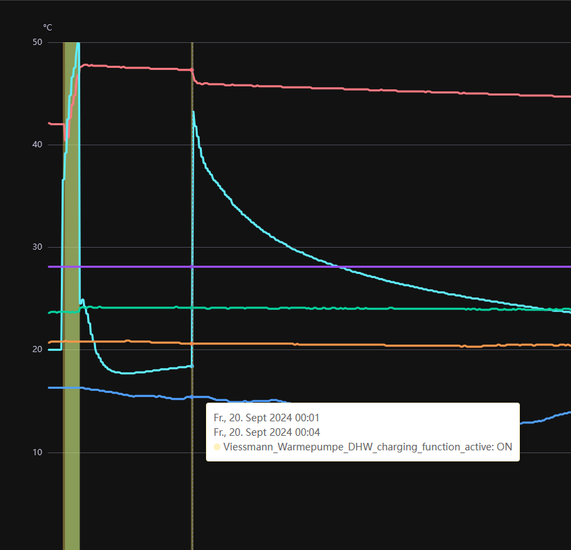

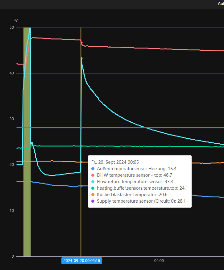

My Viessmann heat pump’s warm water buffer’s temperature drops every midnight. This happens because the DHW charging function becomes active.
Does anyone else see this behaviour or can tell me why this happens? Could the openhab binding play a part in that behaviour?

Found the answer in the meantime. In German it is called “Pumpenkick”, at least for Viessmann devices. All pumps that have not been active for a certain time are activated for some minutes in order to prevent them from getting stuck.
