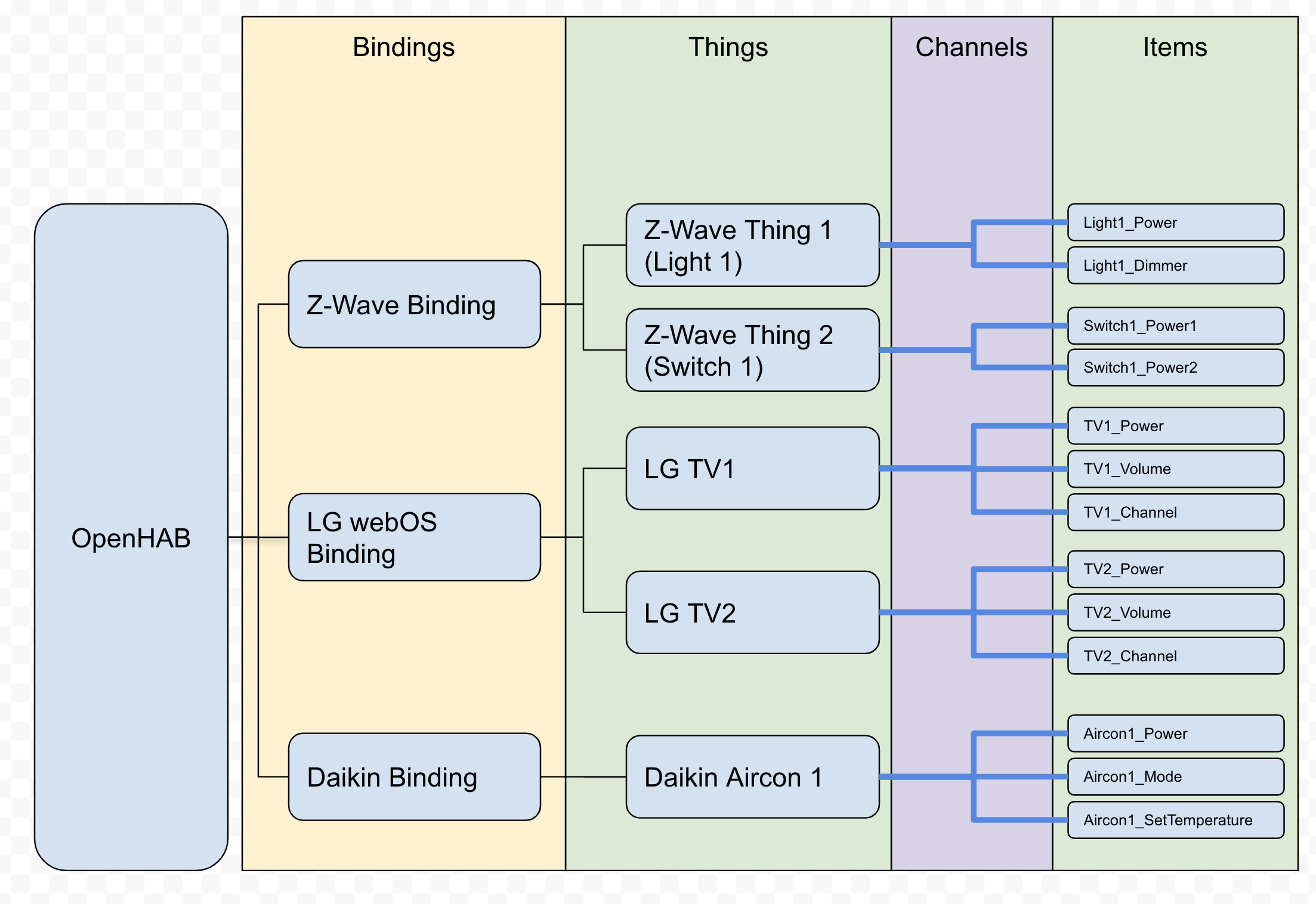

Diagram for the Introduction doc page
Hi, first of all, great job on the new docs. I would like to make a suggestion to include some sort of diagram like this one below on the “Welcome to openhab - introduction” page. You can tell how awesome my graphics design skills are (not!), so hopefully someone can take the idea and make it so much better.
Having a little picture / diagram can do wonders to help people gain a better understanding of openhab’s architecture.
Further thoughts, i.e. notes that should be incorporated into the graphics, perhaps condensed further:
  • Bindings - think of it as the “Device drivers”. You install bindings that will support the devices / things that you have
  • Things - a reperesentation of your physical smart home devices
  • Items - this is ultimately what you interact with from your automation rules
Also perhaps for simplicity, “Channels” should be omitted from the graphics.
Once I’ve got a bit of time today, I’ll open an issue and see how to create this diagram on draw.io / github.
Please open an issue (if there isn’t one already).
My only quibble is it looks like openHAB is separate from Bindings Things Channels and Items.
I also think it would more appropriately be a part of the Concepts Overview page, not the introduction.
There was a version of a drawing like this that also included other important concepts and I think we should not ignore those too (persistence, sitemaps, Pages, rules).
Any drawings submitted to the docs need to be in DrawIO format so they can be edited by anyone.
Such a figure should also highlight the concept of Equipment and Point in the new WebUI
Yes please. Open an issue in the openhab-docs repository and link it here.
We can then discuss and collect suggestions here. :slight_smile:
I edited my original post to add some additional notes.
Perhaps on the diagram it should say “OpenHAB Core”
At first, I also thought that it should go in the “Concepts Overview”, but I edited my post and changed it to “Introduction”. The main idea is that this diagram is the first thing that someone sees in the doc. Someone who wants to know what OpenHAB is. It is to grab their interest before they delved further into learning more details.
Or perhaps this diagram should go into Concepts Overview and another, simpler, more abstract idea diagram in the Introduction page?
In any case, the more “pretty pictures” the better. The Introduction page sorely needs pictures, and higher up on the page as the first thing people would see.
I have been an openhab user for almost 2 years, yet I don’t know what Equipment and Point are. Time to read the docs :slight_smile:
My idea for such diagram is not to show everything about openhab’s capabilities. It is merely as a general “at a glance, what it is about” type of picture, for someone who has absolute zero knowledge about openhab, to grasp the very basic / essential idea about it. In this case, the simpler the better. In fact I think my initial diagram above is still too complicated.
Maybe, but even then all those things are defined by and live in the core. They are not separate. I’d either eliminate the block entirely or draw it all the way around the rest. Or if presented using a layered architecture, show it at the bottom of the layers.
But I don’t think this drawing does that. And you’ll have to add a bunch of text to explain the drawing anyway (drawings never exist without some text to explain it) and by the time you’ve done that half of the concepts section is now living in the introduction.
Were I to come to the openHAB page with no knowledge and the first thing I saw was that drawing, especially with all the additions that have been mentioned, I’d probably be put off thinking OH is too complicated if I’m expected to understand four layers of interaction of concepts before I even get started.
