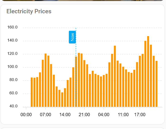

Many thanks. That sounds difficult. For Home-Assistant, there is a widget whic is quite nice:
grafik
I tought there is something similiar with openhab.
