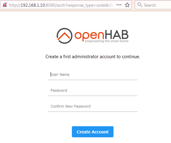

This also seems fine. But when I want to access the configuration page in my browser, I should cerate a first admin account. This seems to be wrong:

So now I am lost. I tried to perform every step exactly as described and the migration still completely failed.
I have not performed the clean up step where the old openhab2 user is removed. I am sure that I did something wrong or maybe the migration does not work on the DietPi distribution?
After reading
and
it also seems that nothing really applies as I cannot even login on the web UI.
DietPi is really way off mainstream so who knows. I doubt anyone ever tried.

Why does this seem wrong. OH 2.5 didn’t have the concept of users. OH introduced the concept of users and roles. There must be at least one administration user. That page is asking you to create one.
Note, this has nothing to do with the users on your operating system (e.g. user you use to log in through ssh).
This is very important.
Anyway, based on what you’ve posted there are no unexpected problems. You’ve a bunch add-ons bindings that won’t work/no longer exist in OH 3 (weather1, gpio1, habmin, paper) but beyond that there is nothing wrong here.
You would do well to go through the Getting Started tutorial so you know what to expect.
Thanks for your answer. As I already created a user in OH 2.5, I wrongly assumed that user would be migrated. Now I know it was deleted on purpose.Good!
Yes, I missed this in the migration guide. I thought there was no additional tutorial needed after sticking to the migration documentation.
Thanks again!
