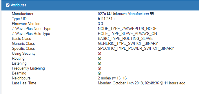

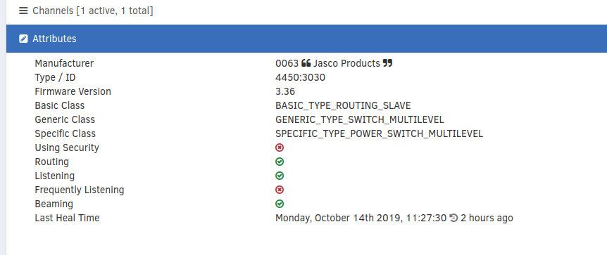

That should be based off its id. From HABmin, go to Configutation → Things → (your switch).
All the way at the bottom of the wight pane, select Attrubutes. You should see something like this.
We are mainly interested in the numbers for the Manufacturer & Type / ID.
Here it is
OK it appears (I am assuming) the vendor used the same ID for a Z-Wave device & a Z-Wave Plus one.
@chris
Are we able to differentiate in the database based on Z-Wave vs Z-Wave Plus?
https://products.z-wavealliance.org/products/1209
