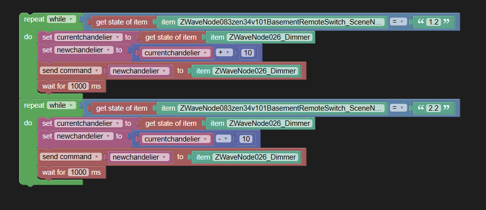

Hi all,
Im trying to use remote scene switches to dim my lights.
Every time i execute it i get the following errors
What am i missing here..
I just want to add or subtract 10 from the dimmer as long as im holding the switch.
2024-01-27 20:21:02.375 [WARN ] [rnal.defaultscope.ScriptBusEventImpl] - Command '-10' cannot be parsed for item 'ZWaveNode026_Dimmer (Type=DimmerItem, State=20, Label=Chandelier, Category=DimmableLight, Tags=[Point], Groups=[ZWaveNode026])'.
2024-01-27 20:24:11.940 [WARN ] [rnal.defaultscope.ScriptBusEventImpl] - Command '1010' cannot be parsed for item 'ZWaveNode026_Dimmer (Type=DimmerItem, State=10, Label=Chandelier, Category=DimmableLight, Tags=[Point], Groups=[ZWaveNode026])'.```
You may need to clamp the value to between 0 and 100.
you’re getting a string from your dimmer item. Then your operations are done on strings and returned as strings which causes the error.

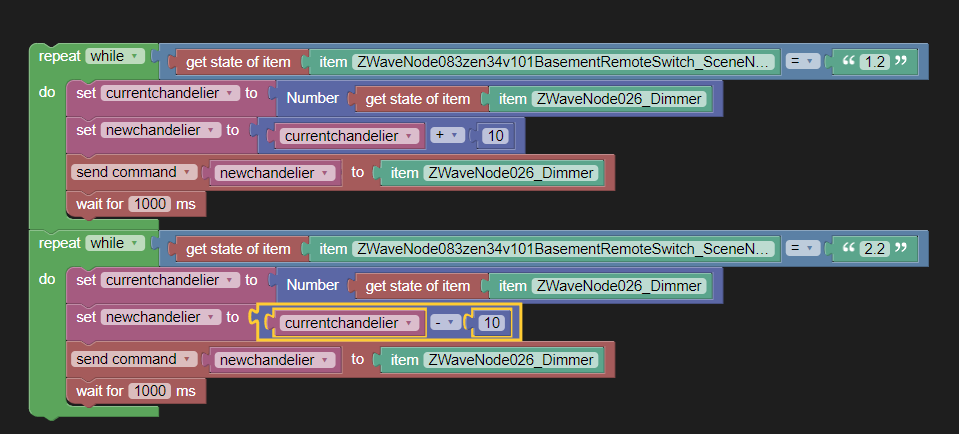

If you use OH4 then you have the number-block under “math” to convert to a number.

In openHAB4, use get <numericState> of Item (<numericState> is part of the dropDown list, default value of this list is <name>)
IMHO this is because Strings often return Units with the value like 1000 K(elvin) which results into a String. As Udo has mentioned, just use the numeric state instead.

Thank you! Added the number conversion and were all good!

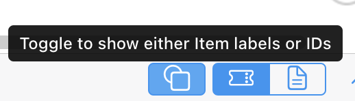

Looking at your long item ids I wonder if you know this toggle which shows the item name instead?
