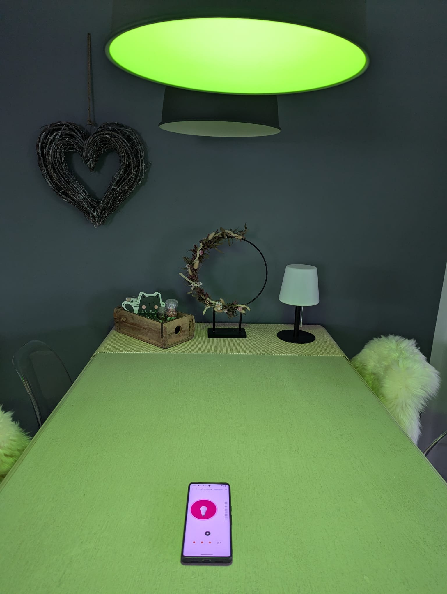

During implementation the DIRIGERA gateway shows it’s badass behavior. Setting color while bulb is off the command is acknowledged AND confirmed by the gateway. But in fact it doesn’t work.
You can trick also IKEA App with one curl command setting color e.g. to red while it’s off, then switch it on via app. Bulb is shining Hulk Green while App thinks it’s Ferrari Red. Reproduction rate is 100%.
So currently color cannot be set in beforehand. Next difficulty is to adjust color and brightness when switching on. Doing this very quick results into inconsistencies - color or brightness will not reach their target states randomly.
