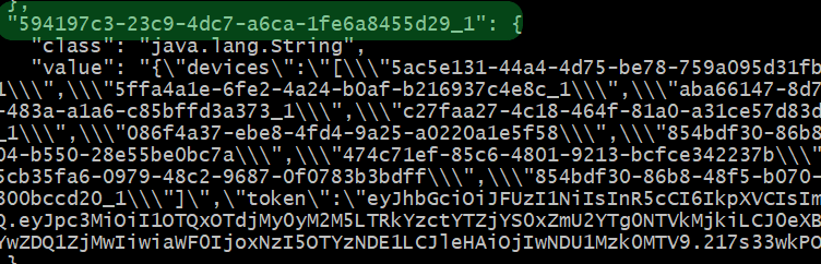

@weymann, I’ve configured my bridge through textual file, however, any time the file gets reloaded, the binding is asking me to again press the button on the Dirigera hub to get a new token. This also happens during a reboot.
Oh this damn text configurations :frowning:
Ok, problem is I stored token using key device id but this doesn’t work if it’s not known at the beginning. I’ll stiore it with key ipAdress and now it should be fine.
Binding is replaced in top post.
Edit:
If you replace in /var/lib/openhab/jsondb/dirigera.json the device id in green with your IP address and do a reboot you shouldn’t need a new pairing.
@weymann, that worked thanks.
