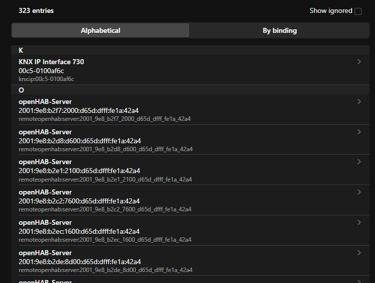

I run a test-openHAB in a docker, which somehow(?) get autodetected. right now it’s 322 of them:

Seems to be IPv6 specific (bits 33 to 64 are different in each entry, at least the ones shown by the screenshot), afaik this is part of privacy-extensions.
Yes, that’s what’s apparently behind it. But the docker container does not fire up every day or so! :wink:
it’s only restarted with the OH-updates.
all standard docker setup. Perhaps the container itself gets (or asks?) for a new IPv6 after lease time is up…? I’m not that firm with docker to get into that specific configuration.
privacy extensions result in changing IPv6 very frequently, depending on configuration, these are temporary IPs and are valid only a (relatively) short time, maybe 6 hours.
