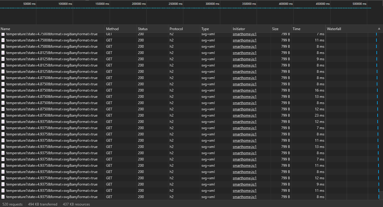

I have temperature sensors that are publishing their value as soon as its available (~ 800ms) as I am drawing a realtime graph in Grafana.
Problem is, that BasicUI is trying to fetch a new icon with every item update (which is useless in this case as there is only a default icon for temperature icon):
Group:Number:AVG OutsideTemp "Outside temperature [%.2f C°]" <temperature> (Outside, Temperatures) ["CurrentTemperature"]

I have tried copying temperature.svg icon in icons/classic folder, but it changed nothing.
Is there a way to disable icon updates for specific items?
Running on openhab2/testing 2.5.0-1

Well its not actually a problem - just annoyance:
  1. In Android OpenHab app the item icon is constantly flickering - probably because its re-rendering it this often.
  2. Its wasting bandwidth in cases of slow connection (like bad 2G we re having here if 4G drops for some reason) - this bandwidth could be used for example to successfully post command to open the gate when I am freezing outside trying to open it… :joy:

It seems like the BasicUI is updating icons only for items on current page (block created using {}) - So I could display the average value on the root page and create sub-page with the realtime values.
But it would be great if this could be handled in some of the future release.
Or at least do not try to update the icon if the value was not changed (reloading icon if value was updated from 4.000 to 4.000)…
